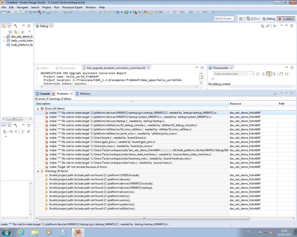

I have installed SDK 3.0 and KSDK 1.2.0
If I try to import an example project without coping it to the workspace all seems to be ok.
If I set copy to the workspace I have a lot of errors as seen in the attached screen.

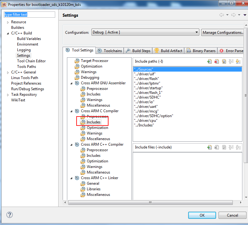

1 ) Please checked "Include paths" here :

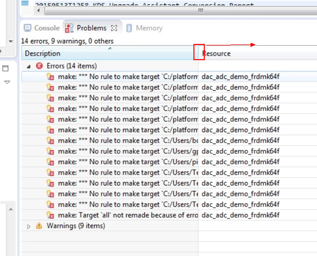

2) Please do like this then show more error information to us :
3) You can also do like this :

piergiovannigor

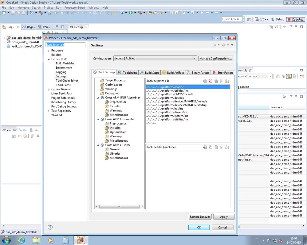

The included paths are as shown on the attached jpeg
I have copied the content of the folder c:\Freescale\KDS_1.2.0\example\frdm64f\demo_apps\dac_adc_demo\kds
to a folder dac_adc_demo in workspace.kds, start KDS and imported the project from workspace.kds.
It does not work.
