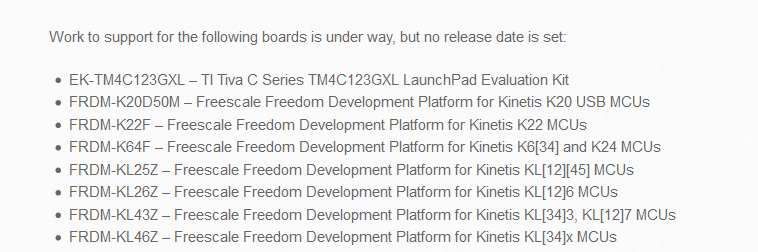

I have chosen to install KSDK as a plugin in an Eclipse install where I successfully squeeze the GNU ARM Eclipse, everything seems to work perfectly, I create the project using the KSDK Wizard, it compiles perfectly, but since I still do not have a card for Prototyping tests intended to use QEMU for the first studies.
How can I do this?
I've had success in using QEMU with STM32F4 and other ARM tests.
Grateful.

- It seems that QEMU work to support some kinetis chips ,while it not release :
The GNU ARM Eclipse QEMU
And it is open source,  NXP have not a office DOC about how to use it .
- There is another simulator  uTasker , it support kinetis , please check this thread :
Kinetis K24 devices simulator
Hope it helps

I talked to Liviu Ionescu, and he suggested I focus on the NXP / Freescale plugins, which he is also involved in since they use the GNU Arm Eclipse Plugin.
I also tried using the debugging option with QEMU from the same plugin, I had already tested with the Stellaris STM32F4 and I was successful, but I did not get any results or error messages with the Kinetis MK22 from NXP.
At the moment I can not get the uTasker license.
