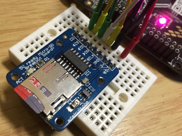

I'm using the Adafruit breakout board, see  https://mcuoneclipse.com/2016/07/09/fatfs-with-adafruit-microsd-breakout-board-and-nxp-frdm-kl25z/
and the attached project.
I hope this helps,
Erich

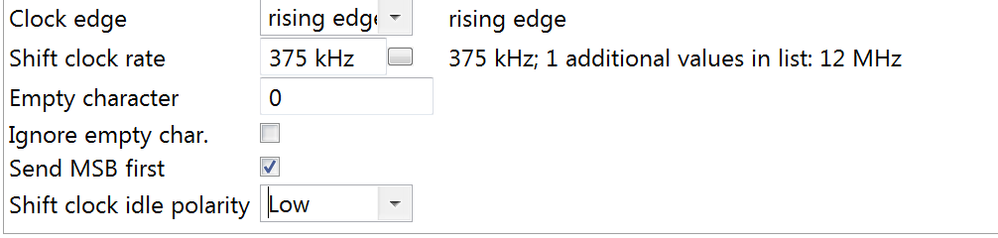

look, this is my SPI communication parameters.
it was on rising or falling edge, i change it to only rising edge. but i still have the same answer, the command diskinfo doesn`t give me any info

Can you checked your SPI communication parameters?
- MSB first
- shift clock low if idle
- clock edge: risinig edge
Erich

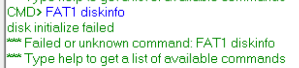

HI Erich! i'm having a little issue when i download the example code that you gave me, the code works fine, but the FRDM doesn`t see with the SD...
when i type the command diskinfo it gave me this answer.
