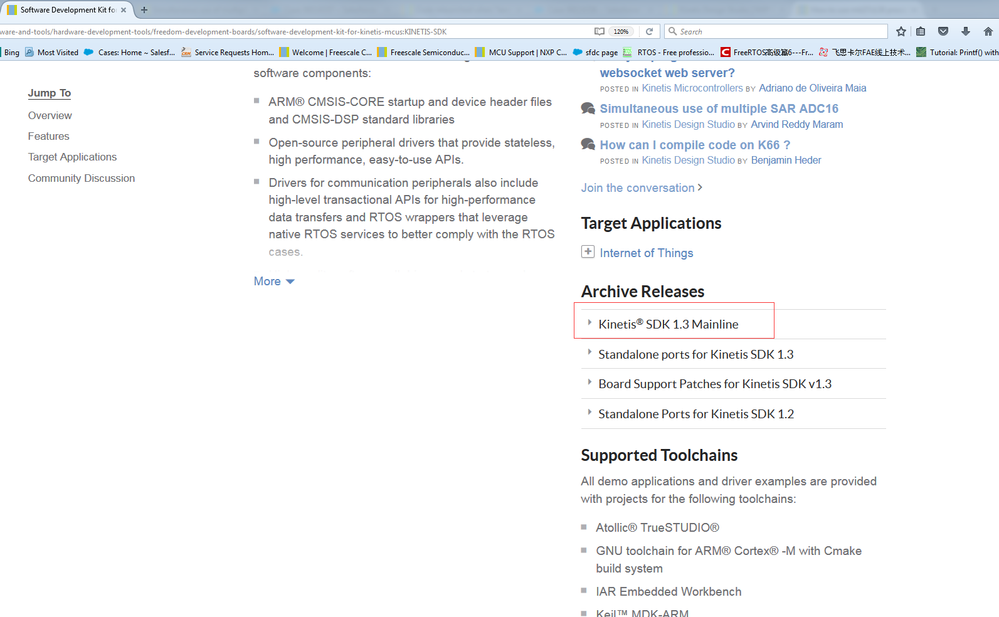

Hi  humberto,
There are two methods:
1. Please download and install the KSDK 1.3 Mainline to KDS,
you can download it at here :
http://www.nxp.com/products/software-and-tools/hardware-development-tools/freedom-development-boards...
Please refer to the users guide -> 4.1 Installing Kinetis SDK to install it into KDS , I attached the users guide for you.
 2.  You can also use the KSDK v2.x, please refer to :
https://community.nxp.com/docs/DOC-329662
Hope it helps
