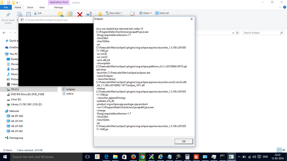

I did the above steps now I am in Step 5 and I want to Install Eclipse but I got an error like this.
How to Fix this

I think you have downloaded the 64bit Eclipse, but you are using the 32bit version of Java/VM.
You need either the 32bit of Eclipse, or better use the 64bit of Java.

Senior Contributor I
    Thank you you were right.Can you say me based on what messages in the Screenshot you are saying that I am using 32 bit Java.
