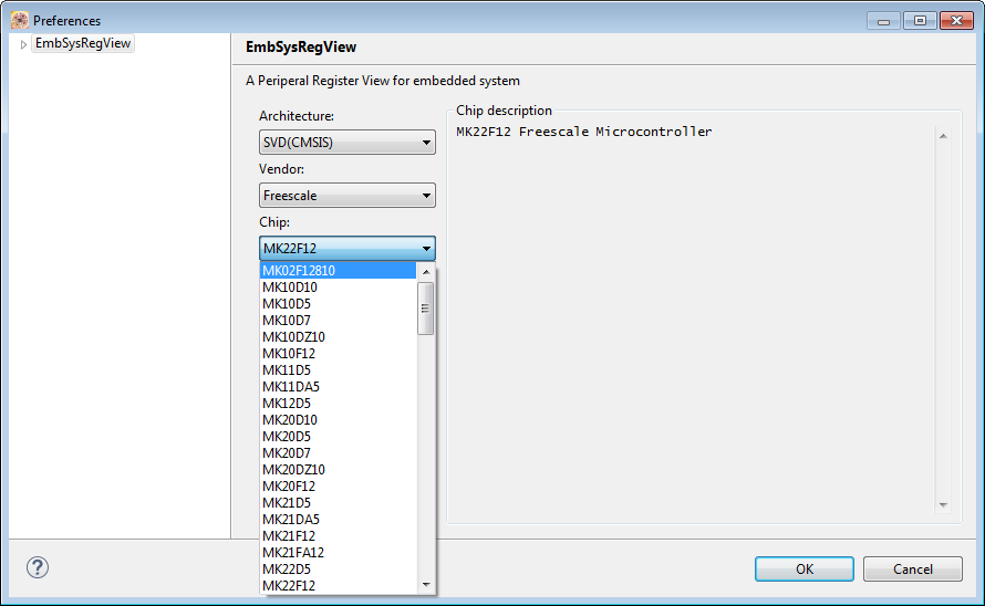

Hi Sir :
         There are many Kinetis device can not be found in KDS3.0 Embsys register viewer . For example , KE , KM , KV3 , KV4 .... series .
Is there any update to add those device in register viewer  ?
Thanks .

ZhangJennie
please make use you have all KDS updates installed.
if still can't find the missing device,
please unzip attached package and copy the content into your KDS embsysregview install folder
C:\Freescale\KDS_3.0.0\eclipse\plugins\org.eclipse.cdt.embsysregview.data_0.2.4.freescale\data\SVD(CMSIS)\Freescale
there is 107 devices included, KE , KM , KV3 , KV4 .... series are also included.

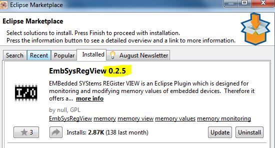

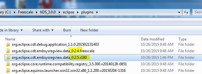

I found the issue why my KDS3.0 miss so many Freescale device .
There are two embsysregview in my KDS folder , one is Ver 0.2.4 another is 0.2.5.r180 .
I checked "Freescale " folder in those embsysregview folder .
Ver0.2.4 support a lot of Freescale Kinetis device .
Ver 0.2.5.r180 only support a little standard parts .
However , Ver 0.2.5.r180 embsysregview is engaged in my KDS3.0 , so many Kinetis device are missed .
Now I copy Jun's attach file to 0.2.5.r180 folder , and it works .
