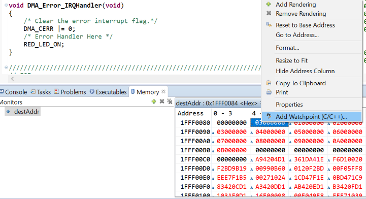

I'd like to set a memory watchpoint in KDS (v3.2.0), so that program execution halts, if the memory location is loaded with a specific value.  Is this possible?

Yes, in the memory window, after you add a memory monitor, you can right click on the address you want to set a memory watchpoint, click on "Add Watchpoint (C/C++)" and this breakpoint will appear in your Breakpoint view:

Thanks, but I already know how to do that.  It will pause execution every time the value at that memory location is changed.  I needed to be able to pause execution only when the memory location is changed to a specific value.  I'm debugging a data buffer, so the values at the memory location change frequently.

Hi Jim,
you can specify that in the 'condition' field of the watchpoint, see towards the end of C/C++ Watchpoints with Eclipse Kepler | MCU on Eclipse
