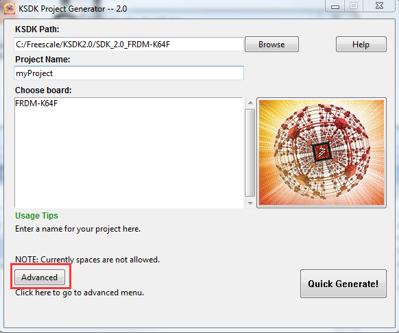

- After you open the KSDK Project Generator , click "Advanced" :

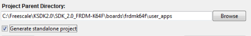

- Then configure this view refer to your requirement :

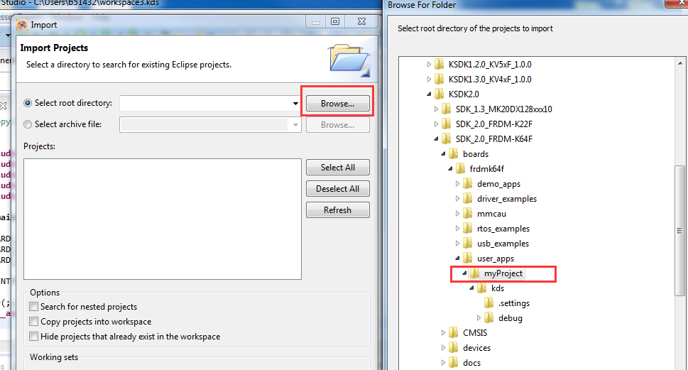

- The project have been generated ,it under the Project Parent Directory you configured :

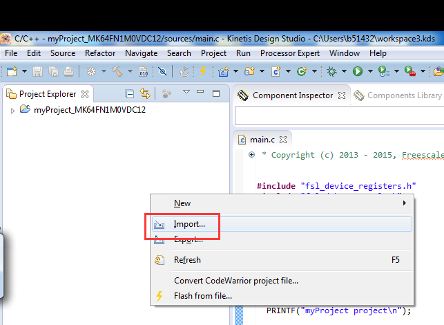

- If you want open it on KDS, please open KDS, then  click Import :
- Select the project you create :
