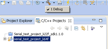

rémiraynaud
Hello Alice,
No I want to build my project with release configuration (optimization)
But I don't have the choice : just debug...
Rémi

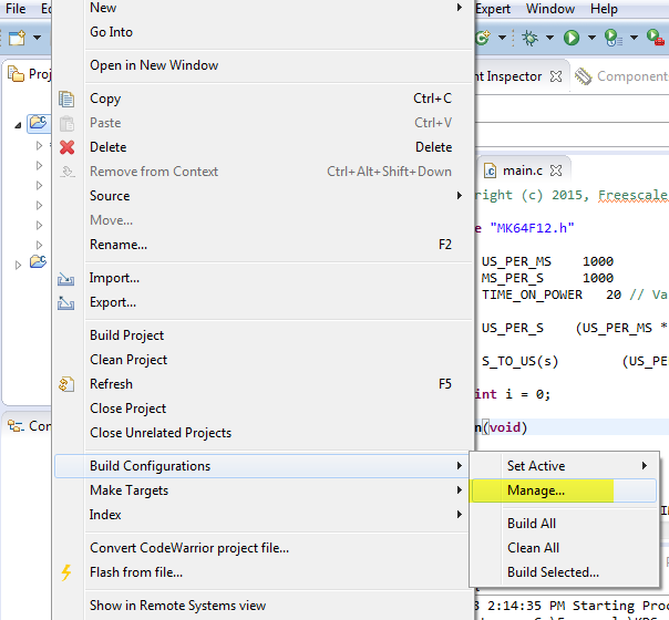

patricio
Hello ZhangJennie,
I have the same inquiere that Remi had.
I am working with a TWR-K64F120M and Kinetis KDS V3.2.0 with Processor Expert and not SDK. I see that KDS has not the option to build in Release, or at least I am not able to find it. Does it have this option?
In my project, I need to toggle a GPIO pin as fast as possible, and I would like to build in Release with highest optimization.
Thank you in advance.
Best regards.
7,302 Views

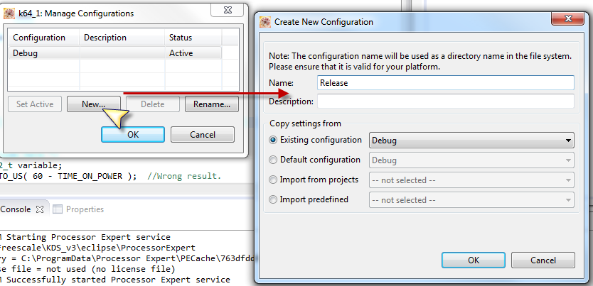

ZhangJennie
Hi Aitor,
Normally when we create a new project with KDS wizard, we don't see "release" and "debug" option. these options exist in some demo code, for example, MQX demo.
If you need it, you need configure it by yourself.
Step 1. Create a new build configuration. Right click on the project name, “Build Configurations”, “Manage…”, “New” to create a new Build Configuration.
step2, if "Debug" is already there, create new for "Release"
step 3. configure each of the configurations in properties.
Jennie Zhang
