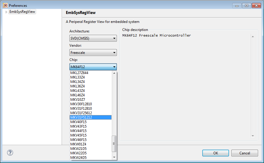

How do you display port and module registers in Kinetis Design Studio?  So they can be changed
Are these registers in the configuration registers?

Hi Ken,
you need to install an additional plugin.
See
http://mcuoneclipse.com/2014/05/29/how-to-add-register-details-view-in-eclipse/
Then apply the V0.3 patch from SourceForge which has the Freescale CMSIS-SVD files in it from McuOnEclipse - Browse /Eclipse Plugins/EmbSysReg at SourceForge.net
I hope this helps,
Erich

Hi Erich,
I can't find the chip KV31F51212 in V0.4 patch. How could I do?
B.R.
Jin Xin

You could use the files from Kinetis Design Studio v3.0.0:
Erich
