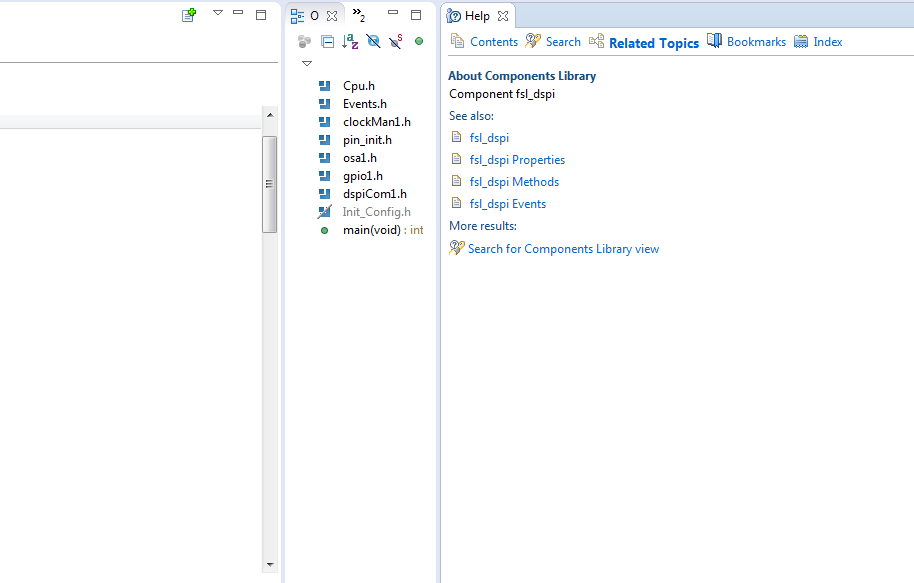

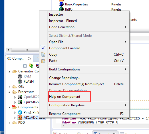

Hi Jace,
There is "Help on component " in each component , you can find the introduce and demo code :
Right click your component , then select "Help on Component":
Hope it helps

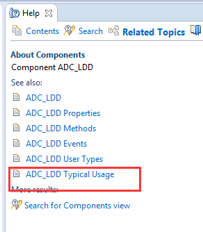

jacewalton
This does help but not of the components that I looked at (several of them including ADC) have a typical usage.

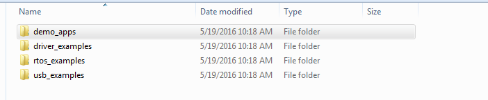

Hello Jace,
Sorry the KSD_2.x doesn't support PE.
The demos all without PE, you can find under KSDK folder :
SDK_2.0_FRDM-K22F\boards\frdmk22f
Hope it helps

Hello Jace,
- Only the Processor Expert without SDK has "Typical Usage", the PE with SDK  hasn't .
- When use KSDK, the API on PE is the same with KSDK without PE, so you can refer to the KSDK API RM:
KSDK_1.3.0\doc\Kinetis SDK v.1.3 API Reference Manual.pdf
And  the demo under KSDK:  KSDK_1.3.0\examples
Alice
