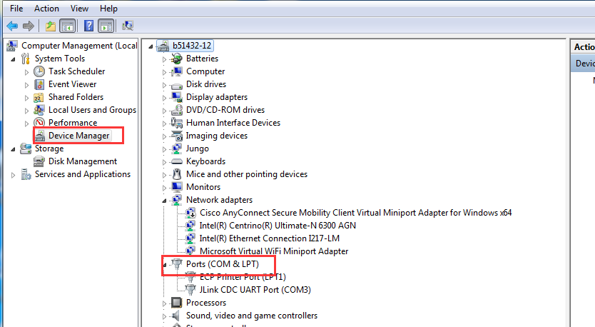

I'm new to NXP. I tried to use the FRDM-KL26Z and run my 1st program. After building the program successfully, I had an issue with the Run/Debug process. This is the message I got:
..Error in services launch sequence
Please check the connection to target or check if another instance of pegdbserver_console.exe is not running....
I went to Task Manager in hope that I will find the said process to kill, but I couldn't find it.
I believe I followed all the required steps to download the KSDK 2.0 and KDS 3.2.0 and other Eclipse SW updates.
Can someone please help me to identify what the problem is?

Hello Ha,
Which debug mode do you used ?
First please refer to the Quick Start Guide update the bootloader.
Please check the attachment .
If still can not work well ,  please show the steps how to debug , also the configuration of KDS debugger .
and show the Device Manager of your PC:
