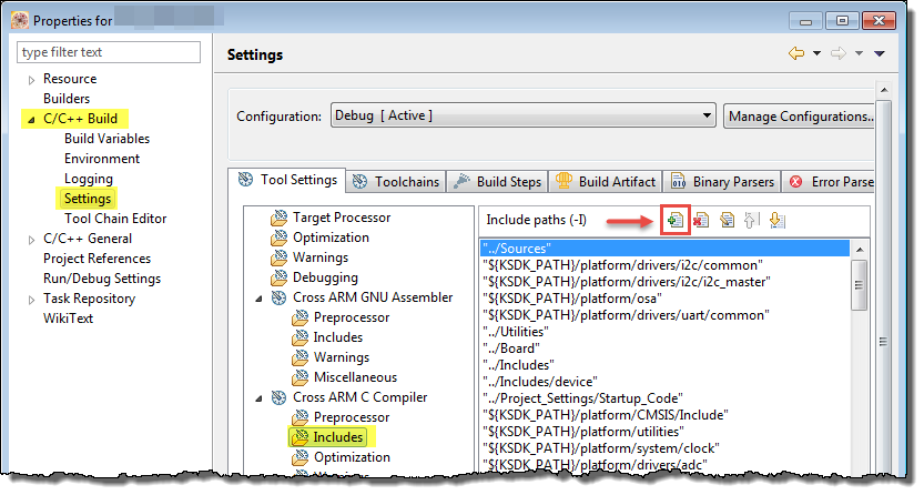

On a related note, what's a good way to include all the necessary .h files? Right now, this is my quite cumbersome process:
1. Build project
2. get error stating that a particular .h file is missing
3. search my KSDK installation file for the particular .h file
4. add the .h file
5. repeat the process until build gives no errors.
There MUST be a better, more logical way to do this. Can anyone help?

Colleague Santiago provided very  good suggestions there. Just to add that in his image you can see 5 projects; uncheck all but the FRDM-K22F one, or you will import all of them. For more instructions on this you can consult Chapter 7.3 of the K22 Users Guide at:
C:\Freescale\KSDK_1.0.0\doc\Kinetis SDK K22 User's Guide.pdf
And regarding header files, you do not have to copy them to your project. If compiler complains about not finding a .h, just find it in your KSDK installation and add the corresponding path to the .h file in Project -> Properties -> C/C++ Build -> Settings -> Cross ARM C Compiler -> Includes, as next:
