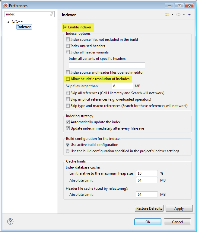

Hi Donald,
if F3/Open Declaration does not work for you, then this probably means that the Eclipse Indexer is not correct.
I recommend that you disable heuristics and rebuild the index, see http://mcuoneclipse.com/2012/03/20/fixing-the-eclipse-index/.

Erich,
I tried your suggestions with the same results. My Indexer window has more options than the one shown, but I set mine similar.

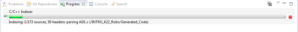

I can’t tell if anything is happening when I force a rebuild of the index. I don’t see any indication that the index is being rebuilt.

Donald,
yes, that dialog looks differently in Eclipse Kepler. Below are my settings:
If you do a rebuild of the index, it is shown int the progress view:

OK, my settings are the same, but nothing happens when I rebuild the index.
