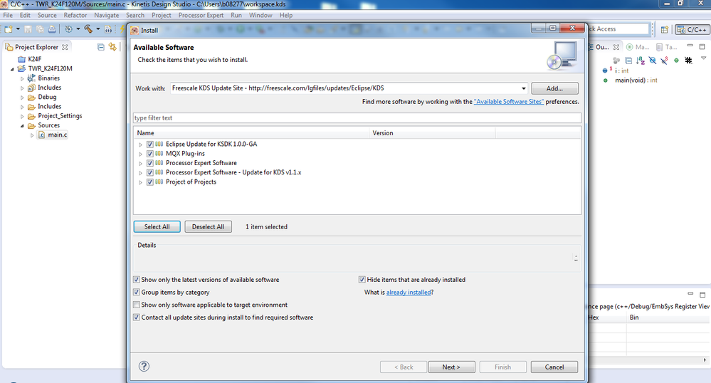

I am trying to create a Kinetics Design Studio project, by executing New>Project>KDS Project, then I followed the Project Wizard, when I clicked finish the files are not created.
The Project Explorer window is empty.
Also, Do the Design Studio tools support the TWR-K24F120M development board. When creating the new project the TWR-K24F120M is not in the list of boards. Is there a new release of the tools to include the TWR-K24F120M in the Kinetics Design Studio tools?

Hi Rafael,
I tested creating a new project and TWR-K24F120M project, there is no problem, see attached two videos.
here is some points we need to pay attention:
1. make sure you have admin right of install and using KDS . it's necessary.
2. to avoid old file associations, remove .metadata folder under your workspace folder, then restart your project again. test same.
3. make sure you install the latest KDS version: KDS2.0
http://www.freescale.com/webapp/sps/site/prod_summary.jsp?code=KDS_IDE&nodeId=0152101E8C1EB4&fpsp=1&...
4. make sure you install all the available update:
does this answer your question?
