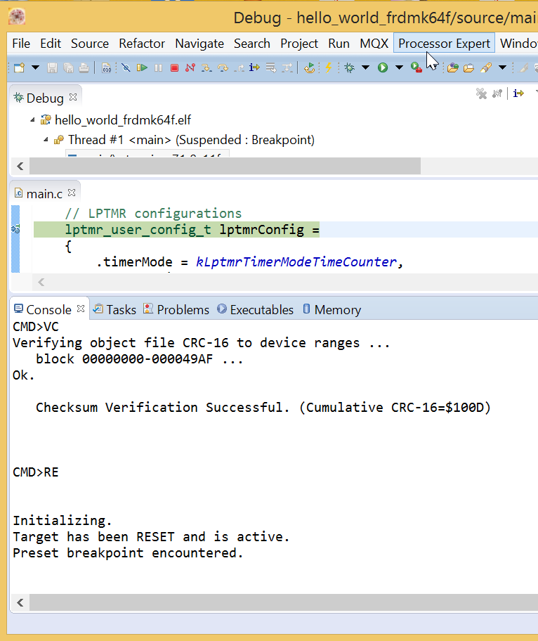

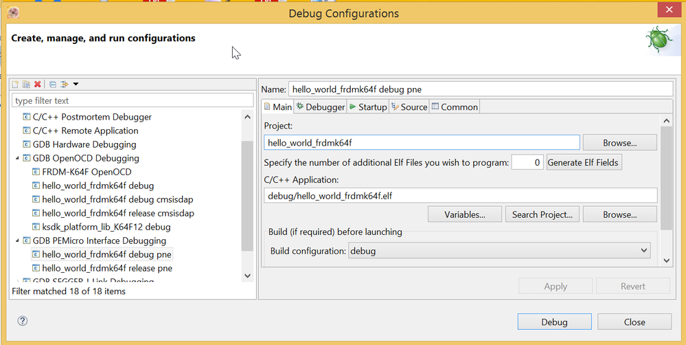

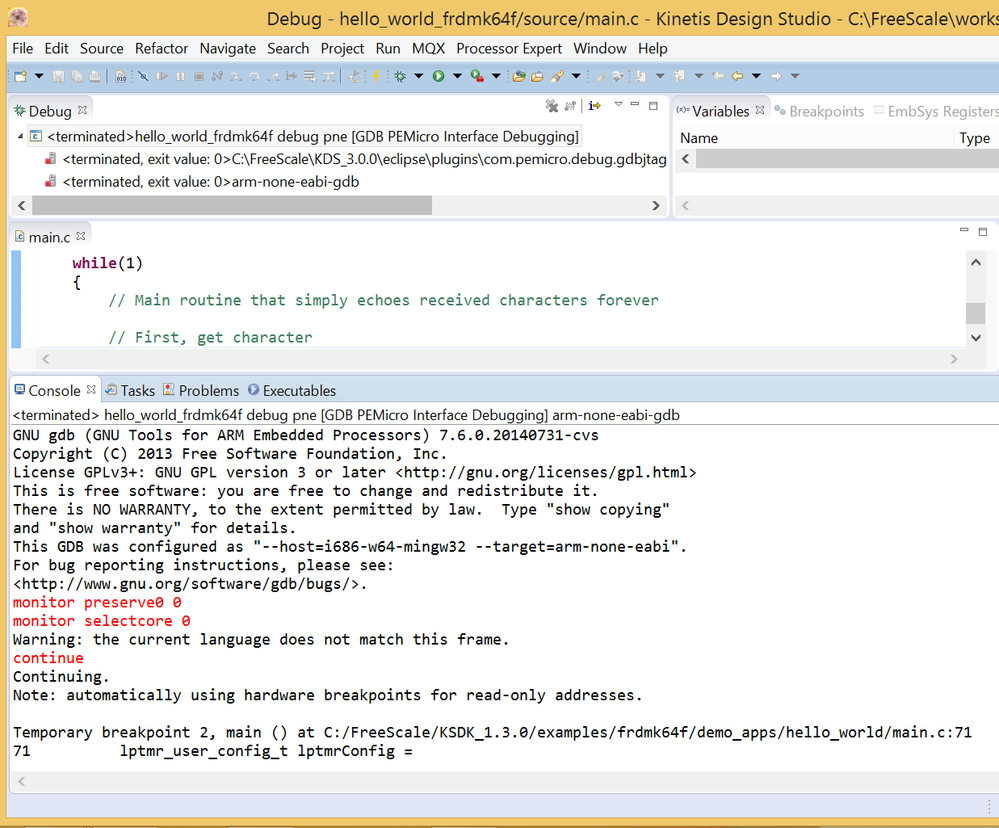

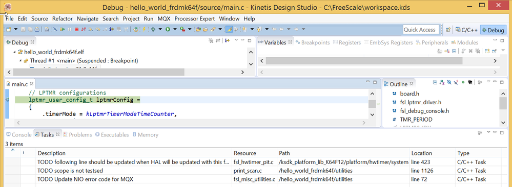

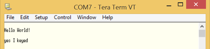

Thank you Gabriel. I found the file: C:\FreeScale\KDS_3.0.0\pemicro\opensda      DEBUG-FRDM-K64F_Pemicro_v108a_for_OpenSDA_v2.0.bin and used Appendix C to install it. I deleted the previous Debug Configurations and used GDB PEMicro Interface Debugging: hello_world_frdmk64f debug pne and used the default settings which enabled me to debug.
Please look through the screen shots. If there is any further actions you would recommend I would be most grateful:
