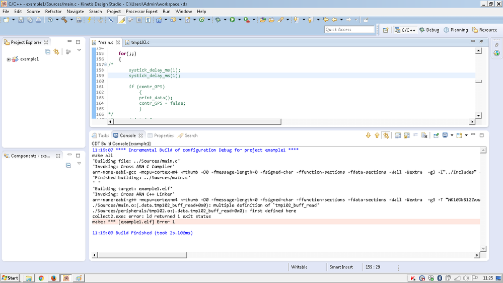

Hello everyone,
I'm using Kinetis Design Strudio to schedule a MK10.
When I make Build the consol gives me an error that is not highlighted in the program.
Here is a picture.
What can be?
1,670 Views
Hello niki,
From the console we can see you define multiple times of "tmp102_buff_read",
and have not define "temp102_buff_read+0x0" or maybe you have not declarative it .
Please check these two place , then build , check the console window whether have other error .
Hope it helps
Alice
1,670 Views
nikivendola
Yes, you're right. I solved. Thank you.
