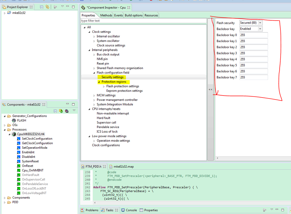

Hi Thanh,
About the Processor Expert project on KDS, you can enable and configure the backdoor in the "Security setting" field :
Hope it helps

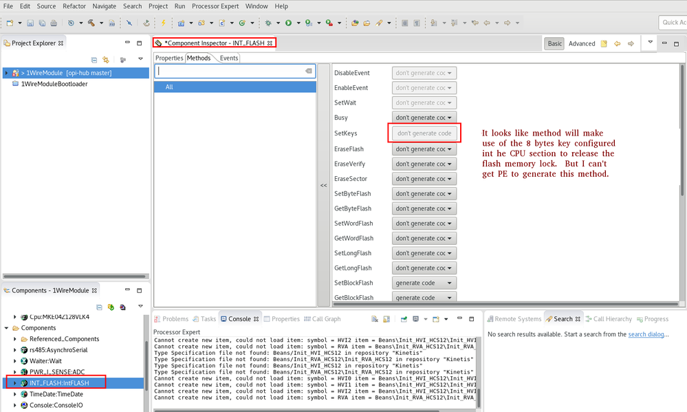

thanhtruong
Hey Alice, I am aware of where to set the backdoor key, it the how to the make use of it that I am unable to find out.  It looks like the PE Internal Flash component is where you'll make use of the key.  However, as you can see below, it is grayed out so I can't tell PE to implement this method.
For this method to be enabled, is there a other requirements that I am unaware of?
Thanh

Hi Thanh,

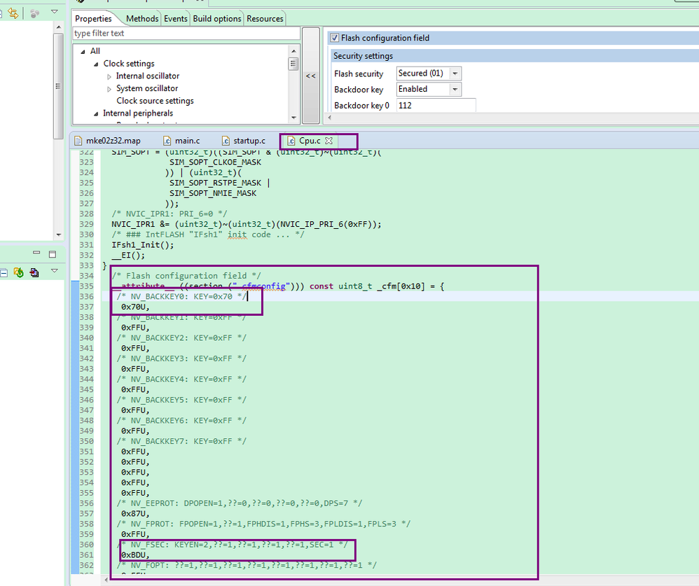

I think maybe this Method "SetKeys" is not support for your chip.
After configure the backdoor in the cpu component,  you need do nothing,  the generated code
will be on Cpu.c file , and when download project, the flash configuration field code will be flashed into
.cfmconfig section, please check below picture:

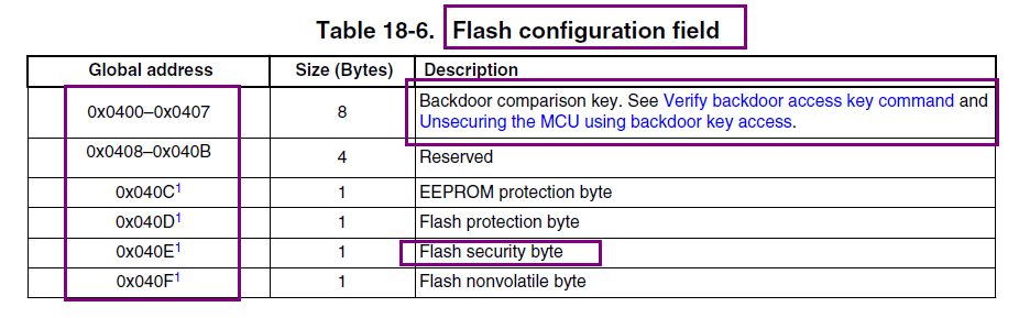

And from the linker file you can see, the .cfmconfig section placed on 0x400-0x40F.
Check reference manual :
Hope it helps

Memory Protection configuration on Processor Expert can be found at:
Processor: CPU: Common settings: Flash configuration field: Protection regions.
