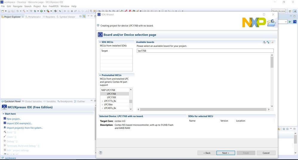

Well I would like to ask where can I find SDK for LPC1768, I assume I need to download it as I had with KDS.
Seems like there is no lp1768 on the available board list. I can only find it on "Preinstalled MCUs" but after that I have to choose between multiple wizards, LPCOpen C++, C++ Static ...

There is no MCUXpresso SDK  support LPC1768, so we use LPCOpen library.
Please refer this document of how to create a new LPC project using LPCOpen and MCUXpresso IDE.
https://community.nxp.com/docs/DOC-334959
