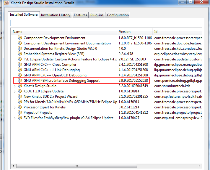

 KDS has:
  - Kinetis Design Studio  3.2.0.201603041649
  - GNU ARM PEMicro Interface Debugging Support              2.9.6.201704281541c.
  I have attached all of the eclipse installs.

Thank you for the reply.
I update the plugins and restarted but have the same issue.
I then updated the multilink FX firmware and created a new workspace and imported the rtos project but still have the same problem.
I attached a number of screen captures. I don't have an app to record the desktop. Can you recommend one.

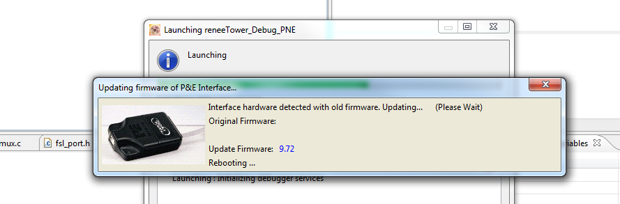

I was able to solve my problem with a firmware upgrade to the pemicro multilink universal FX.I had tried  upgrading by using the tool pemicro provided but I still had the issue.
But I needed to use the Multilink for another processor family so had to change the FW. When I connected back to the kv58 using KDS it did an automatic upgrade (see attached). After this it worked OK.
Thanks for the comments
Joe
