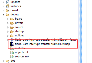

2) You can refer to the *.map file to check detail memory information. And also you can send your
project to me  , i can help you to check .
