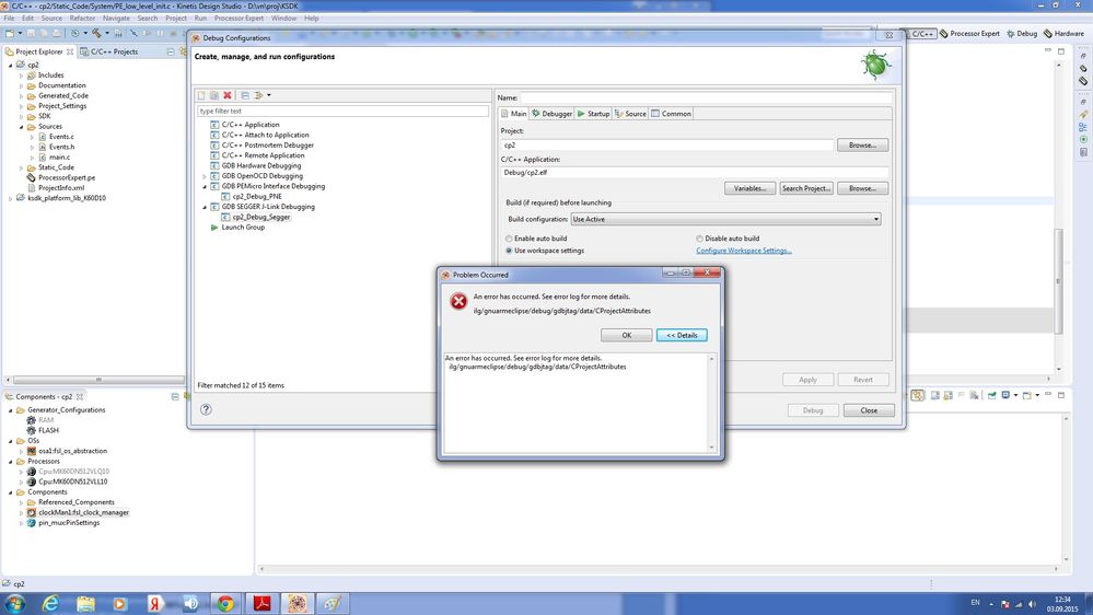

Hi.
I get progect whith PE + Kinetis SDK.
When I create session GDB SEGGER. I get error.
How to correct it?  what not so?
970 Views
BlackNight
Have you performed an update recently? There is a known issue documented here:
Unable to Debug after KDS Update
That discussion has as well the solution/workaround for this problem.
I hope this helps,
Erich
