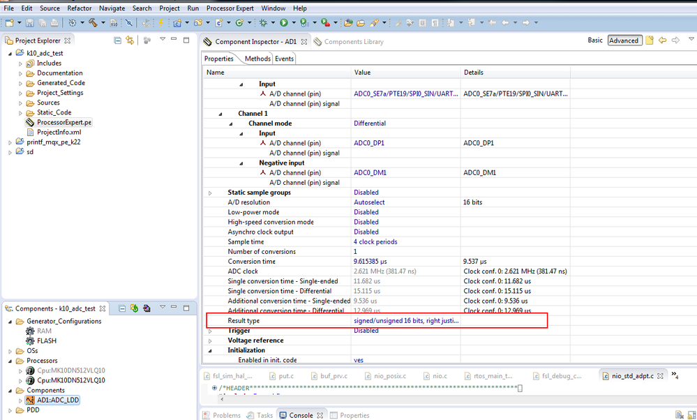

I have a need for both differential and single ended channels. When I use the ADC component from the component library and set some channels to be differential and some to be single-ended, I get the error 'Combining Differential and Single-Ended channel modes in A/D channel list required native result data format'. I have tried changing the Result Type, but I always get this error. Is there a way in KDS to use both Differential and Single-Ended channels on the same ADC? (My hardware is already spun, so it would be difficult to use the other ADC block).
I am using a K10DN512VLL10 with KDS 2.0.

Hello Bryce,
In the "Result type" , please configure as this :
Hope it helps

Perfect, that is what I needed.
