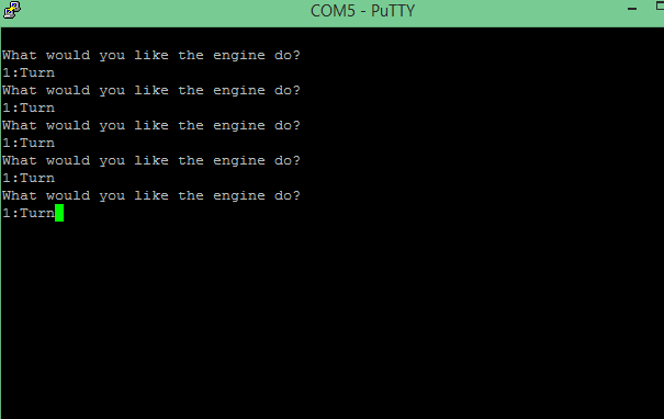

yarannan
Error in final launch sequence
Failed to execute MI command:
-target-select remote localhost:0
Error message from debugger back end:
localhost:0: The requested address is not valid in its context.
It happened when I debug/run the code. What did i do wrong?

Have you terminated any pending debug session? You might get such a message if you try to debug twice the application (the applicatino is already debugged, and you start a second launch).

Hi Eric,
I guess it was and currently it is working now but it wont print out entire content. I will post my code and screenshot above.

yarannan
Hi Alice,
Its running on KDS2.0. Thats my own project. It's running now but it wont print entire contents.
I dont get it. Thanks,
Yaran

yarannan
Hi Alice,
Sorry about that. I attached new project there. I was running another project earlier this morning and I ran into same thing.
Honestly, I was copy and paste ksdk baremetal code into mqx project. That might cause some fatal issue... but i dont know where...
