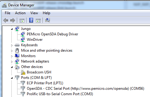

DavidS
Hi Michael,
Head back into the BOOTLOADER and drag-n-drop the DEBUG-FRDM-K64F_Pemicro_v108a_for_OpenSDA_v2.0.bin to it.
Unplug and re-plug in the USB debugger cable to see if it worked.
Connecting 5V to P5-9V_VIN should be OK.
David
6,523 Views
michaelkoller
Hey David!
Thanks for the quick reply!
I did what you said with following results:
After dragging and dropping the specified file into the BOOTLOADER device, the green status LED changes from blinking slowly to blinking fast. When I unplug and replug the board as the next step, the red and green status LED light up simultaneously. I dont see the normal storage device in my explorer. If I unplug and replug while holding reset I can get into the bootloader again.
Having both status leds on simultaneously occured before the unresponsiveness when I posted my initial question here.
Thanks again, maybe you can tell me what to try next?
Best,
Michael
(Until then I'll google red and green led on)
6,523 Views
DavidS
Hi Michael,
What do you see in the Device Manager?
Mine shows the Jungo->PEMicro OpenSDA Debug Driver and Ports (COM&LPT)->OpenSDA - CDC Serial Port below:
So no MSD drive shows up with this PEMicro firmware.  Just debugger and VCOM.
If that stuff shows up on your system then try downloading an example frdm-k64f project.
David
