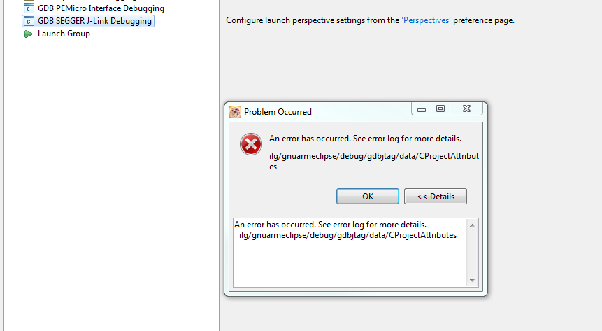

I'm trying to change from PEMicro to Segger J-Link, but stuck imediatelly after clicking on GDB Server J-Link Debugging, for create the configuration for the Segger, and receiving following message:
Someone have some tip?

Hi Carlos,
Have you updated the GNU ARM Eclipse plugins?
I think it is the same problem as described in Unable to Debug after KDS Update  (which has a patch as solution for it).
I hope this helps,
Erich

carloshass
i have 2 environments, one i've update, and another was fresh instalation of latest version.
And same error on both!
p.s.: Debug with pemicro is working(with a lot of "error setting bp"), then i'm trying to change to segger.
Boards is KE06Z.
Will try the link you provided and come back later.
