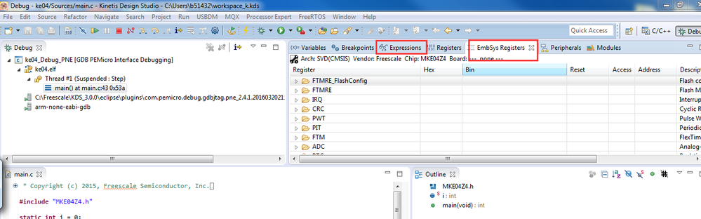

Hello Shawn,
There is a Expressions view can check variable and  "EmbSys Registers" to check
registers .
Does this can helps ?
Alice

ohiogt
Hi Alice,
Thanks for the response.  I think I understand GUI Expression and register views.  I'm just trying to speed up the export of large arrays for analysis in external tools.  I'm hoping to automate this process with a scripting language.
Shawn
