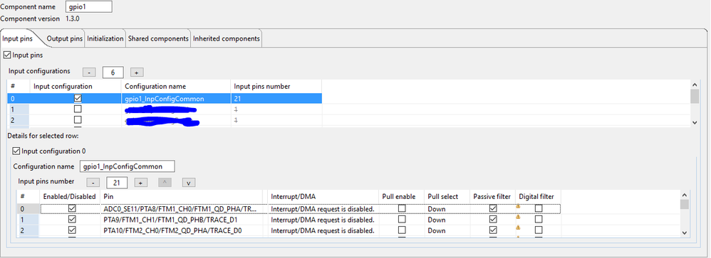

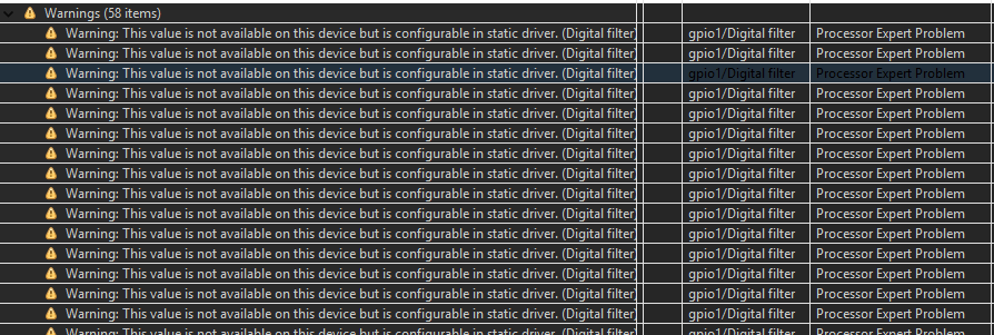

I am looking to disable the following warning in my project (GPIO):
Warning: This value is not available on this decive but is configurable in static driver. (Digital Filter)
Processor Expert Problem.
I don't see a warning number of sorts to disable it.
I don't want to disable all warnings, how can I disable just this warning?

Jason,
I think the message means, that selected pin does not support the feature, even it is configurable in the API.
The Processor Expert warnings cannot be disabled. It is possible to configure content of the Problems view (in Provlems view drop down menu - Configure Content ...).

jasonphilippi
Hello Carlos,
I'm using KDS Version 3.0.0,  Processor Expert with KSDK 1.3 components, and a K24F .gpio-digital-filter.PNG

jasonphilippi
Okay, this is what you are talking about, Help - Eclipse Platform.
  1. In Problems view, click the View Menu icon View Menu icon in the top right corner of the view.
  2. Use Configure Contents... to define your custom filter and click OK.
  3. In View Menu select Show and then your filter.
