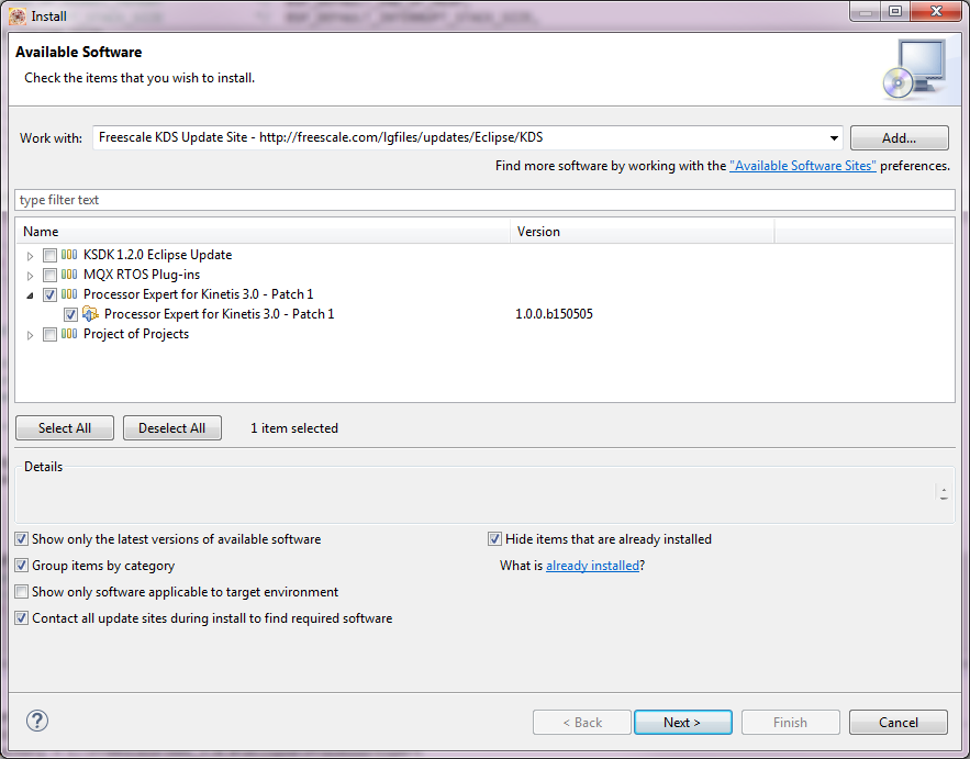

Please, have you installed the new updates for KDS and Install New Software?
I mean Help - Check for new updates and Install New Software,
please check new updates for PEx after that restart your KDS.
Does it help?
Iva
6,739 Views
smachell
I had already checked and installed updates - so that did not fix.
