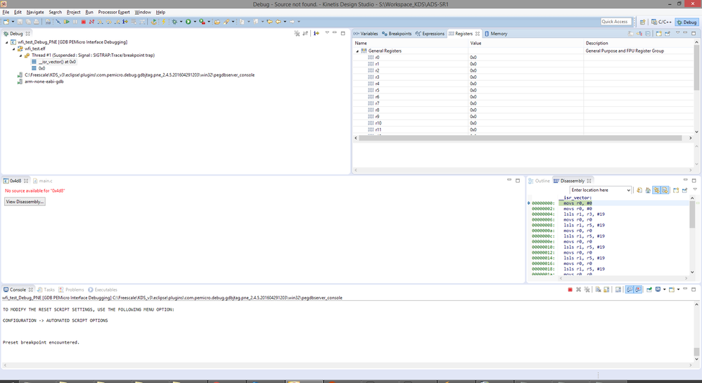

In KDS 3.2 (and KDS 3.0 before that), when the target executes a WFI instruction the debugger stops with the PC and all registers reading 0.  It's still connected and apparently able to read memory, but it can't resume.  If I step into the WFI instruction it steps past it fine, but in normal run mode it stops every time.  The target keeps running normally.
This happens with a P&E Cyclone, P&E Multilink Universal, and with the FRDM-K22F's built-in OpenSDA debug adapter.  I've tested it on the FRDM-K22F and my own MK02FN64 boards.  This problem does not happen in CodeWarrior 10.6 on the same system with the same drivers and debug interfaces, so it's definitely not a hardware problem.  Unfortunately NXP has abandoned CodeWarrior for Kinetis so I don't have the option of using my preferred IDE with the K02 parts.

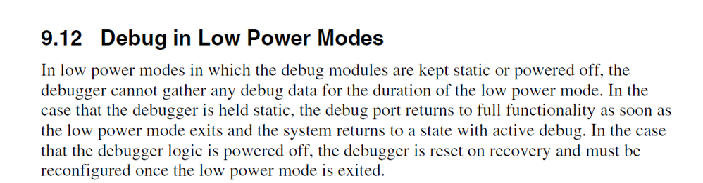

Hello Scott,
In low power modes , the debugger powered off.
For the frdm-k22 board , you can check the Reference manual :
Hope it helps

Hi Alice,
If you look at the next page, 9.14.1 says that the debug port is fully functional in STOP, VLPR, and VLPW modes.  In this case, it's entering normal Wait mode via the WFI instruction with SLEEPDEEP disabled, and according to table 7-1 all peripherals are clocked in sleep mode.
Moreover, the same hardware and same code functions just fine with the CodeWarrior debugger.  Your colleague Jingjing Zhou referred me here after being unable to reproduce the problem, and says that WFI should not stop the debugger.
Scott

scottm
Senior Contributor II
I've done all of that.  I've run the project provided by your colleague and it stops every time.  Or rather, the debugger stops every time.  The target continues running normally after the debugger stops and shows "__isr_vector() at 0x0" and all zeros for the registers.

Hello SCOTT,
I have not use debugger , i use the OpeSDA on board .
Which debugger do you used ? pleas take a screenshot .
What about the system of your PC ? And have you test it on other PC ?
Please create one simple project (not low power), then test it on KDS , check whether can work well .
maybe it is not the reason of low power , please take a screenshot about the configuration of KDS
when you download  the project.
Alice

scottm
Here's a simple project to demonstrate the problem:
https://dl.dropboxusercontent.com/u/13572256/wfi.zip
And here's the configuration of the KDS installation:
https://dl.dropboxusercontent.com/u/13572256/kds_config.txt
We tried it on a Windows 7 machine with a P&E Multilink Universal and it seems to function as expected.  The machine that it doesn't work on is Windows 8.1 Enterprise.
Screen shot is included below.  Note that 0x4d8 is Reset_Handler.

kerryzhou
Hi Scoot,
    Please post your KDS error picture here again, let Alice to check the error is caused  by what factor from the KDS side.
    Besides, If you have the condition, please install your KDS in another PC with win7 system, and try again. The test platform use FRDM-K22, and debugger use P&E multilink or opensda, the project use K02FN64VLF10.rar which I already give you.
    Because, I tried at least 3 computers on my side with KDS3.2 or KDS3.0, I didn't meet your KDS debugger error after enter wait mode.

scottm
Here's the screenshot.
