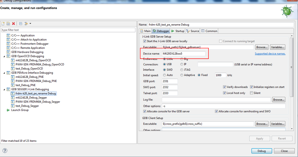

Hello David,
1) Sometimes , after build , if there is no .elf file , please refresh the project :
then when you debug , you will see the file and the debug configuration . please try .
2) if it still have not the debug configuration you need, double click "SEGGER J-Link Debugging"
Pay attention : use SEGGER J-Link Debugging , we need configure the "Device name" manually .
3) if you still not solve it , please send you project to me .

Hello David,

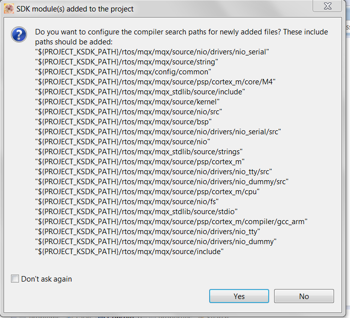

I downloaded the file and unzipped it into C:\Projects\mqx_hello_frdmk22_test1 and then imported it into KDS. When I did the import, I got:
I clicked on "yes" and then did a "clean" and tried to build. I got:
../Sources/main.c:3:17: fatal error: bsp.h: No such file or directory
#include <bsp.h>
I will investigate later, but I have some meetings to run to.
5,674 Views
Hi David,
Please put the project into your " workspace.kds " .
I have test it on my side, change the project to other workspace ,then open KDS in that workspace , the import the project ,it also show the screenshot you said,\
while after click yes , build, debug ,it can work well .
Alice
