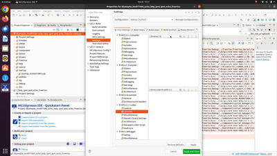

GanesanGuru
Hi @davenadler ,
Can you explain it further - as I can't get it.Let'me explain where I'm stuck.
I've converted project into C/C++ like this and I checked MCU C++ Libraries for the include files/search paths, its completely empty as attached below imgScreenshot from 2023-11-08 15-21-57.png
So, whether we have to include the path additionally? If so, let me know which else should be added so @davenadler ...Thanks in advance
