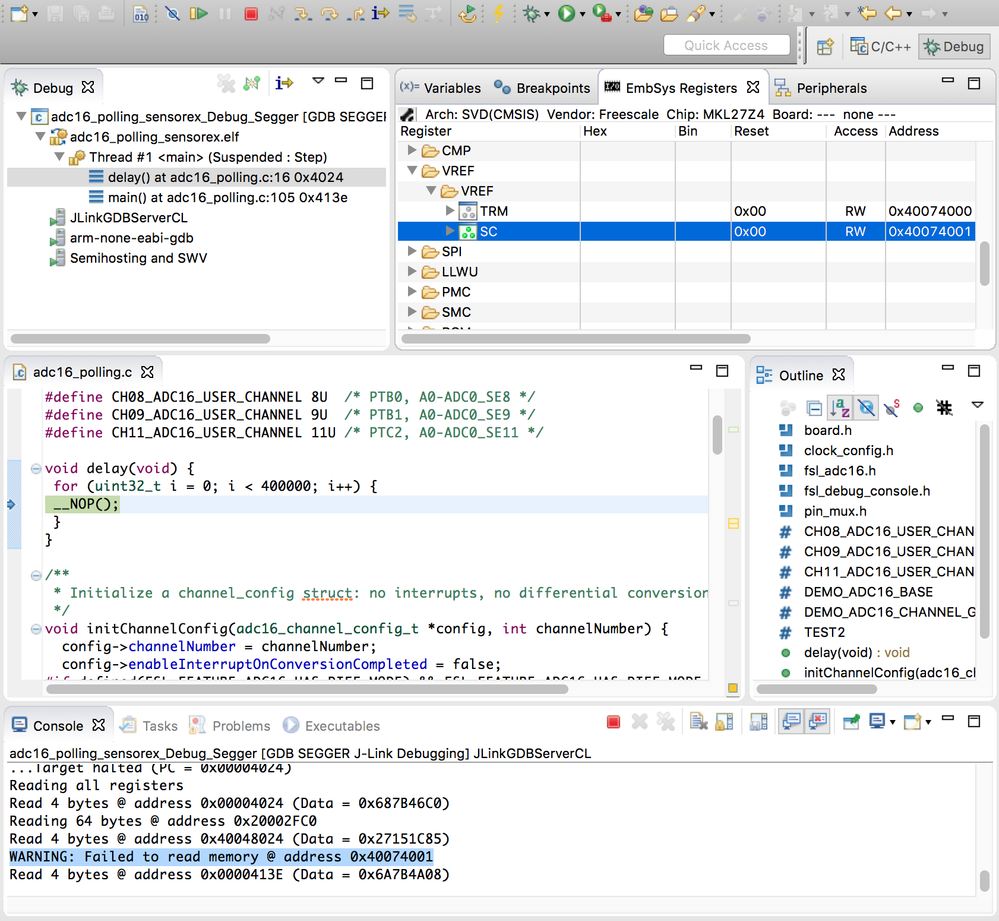

I cannot access the VREF_SC register in KDS 3.20.  When I select EmbSys Register => VREF => VREF => SC, I get the message "WARNING: Failed to read memory @ address 0x40074001"
My environment:
  • Mac OS X 10.12.2
  • KDS 3.2.0
  • FRDM-KL27Z development board with KL27Z64VLH4 processor
  • Segger JLINK.edu
In KDS, in the EmbSys Registers tile, it shows
Arch: SVD(CMSIS) Vendor: Freescale Chip: MLK27Z4 Board: --- none ---
... I believe this is correct.  When I select Register VREF => VREF=> SC, in the console it prints:
... and the result is blank.
Note that it IS capable of printing other registers, e.g. ADC control registers, etc.
Any idea why this is failing, or how I can read the state of VREF_SC[VREFEN]?

You need to enable  the clock gate for Vref Module.
SiM_SGCG4  (VREF) bit.

Hi Robert Poor
Could you share an screenshot of your EmbSys Registers? I noticed that you have:
Arch: SVD(CMSIS) Vendor: Freescale Chip: MK207Z4
But you should have selected in Freescale Chip: MKL27Z4

Jorge:
That was a typo on my part: I get this error when the chip is set to MKL27Z4.  Screenshot attached.
