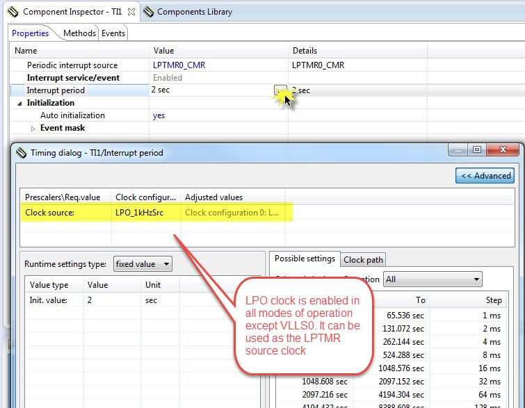

adriancano
It is possible that the clock source you are for the timer is not enabled in low power modes, you need to ensure that the source clock for the LPTMR is enabled during LLS mode. I tested this using the LPO clock, which is enabled in all the low power modes.

adriancano
Peter,
Attached you can find a KDS 2.0 project for a Kinetis KL25, the application is set to wake the MCU from LLS every 2 seconds using the LPTMR interrupt clocked by the LPO clock.

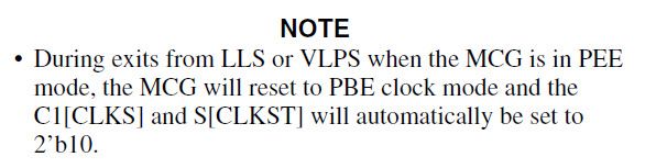

adriancano
Good to know you solved the Wake-up problem. In my example I am setting FEI mode and after exiting the LLS mode the core settings return to FEI mode. I am not sure but I assume you are using PEE mode and then enter to LLS mode, after exiting LLS mode the MCG will be in PBE mode, you need to ensure to return to the first configuration before the UART transmission.
Here the note form the reference manual:
Using PEx you can just call the method:
/*Moving to LLS mode*/
/*Waken up*/
Cpu_SetClockConfiguration(CPU_CLOCK_CONFIG_0)/*Moving to clock config 0...Now in PEE mode*/
/*Printf()*/
