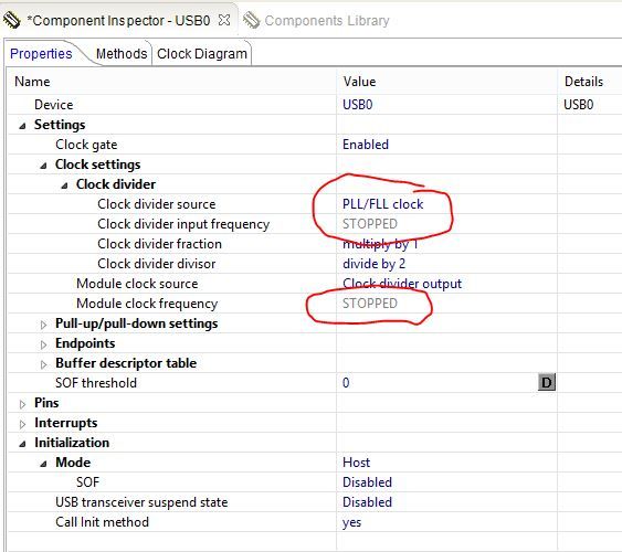

I'm using KDS200 with ProcessorExpert FSL_USB_STACK and when I see the
FSL_USB_STACK . Settings.Clock settings. Clock Divider its marked as STOPPED
I've got my
ClockSource0 as a lowPower LowSpeed Clock on startup
ClockSource1 as 96Mhz clock
Is this why I'm getting STOPPED?
Is there anyway for it to use Clock Source 1?

Hi Neil,
RE question 1: If it shows 'STOPPED', it means that this input clock to the USB module is not running. You problably have not selected the proper PLL/FLL clock in the output settings in the CPU component (setting shown for K64F, but should be similar for your K20):
Make sure you select 'PLL' there, so the PLL clock is routed to the USB peripheral.

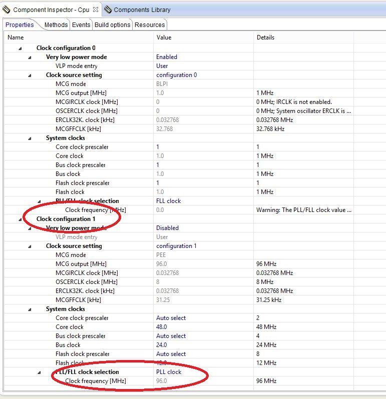

Here is my clock sources -
ClockConfiguration1 does have the PLL/FLL clock selection enabled,
but NOT ClockConfiguration0 - so I'm guess the FSL_USB_STACK is  keying off ClockConfiguration0. There isn't a choice that I can see of.
I did have a look at the "ProcessorExpert.pe" file to see if there was anyway I could switch around the definitions of Clock Config/Source 0/1 - but the tags didn't match textually to what I see on the screen.
So I assume I'm going to have to work through recreating the clocks with the USB being defined in Clock Config 0
Its probably not a lot of work - I initially had ClockConfig0 as a low power startup, but I think there are other ways of ensuring a low power startup - still have to experiment.

It is using clock configuration 0, I don't think there is a way to get around this.

I've moved all the clock settings to ClockSourceSetting0  for 48Mhz and it compiles, downloads OK and runs.
