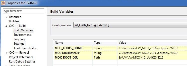

The needed build variables are correcly added as below.

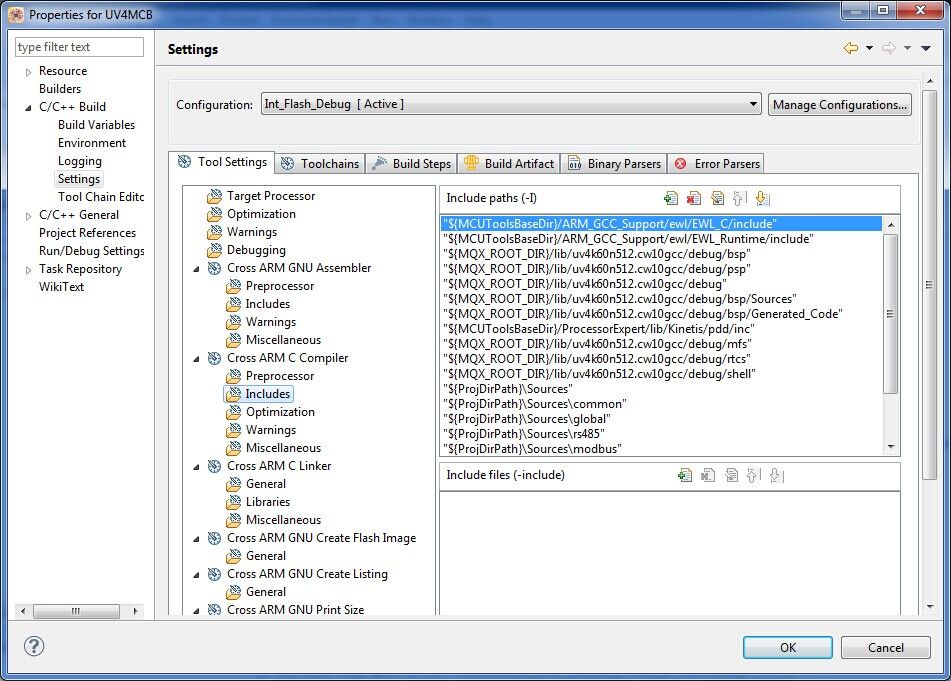

And all the source path are included as below. I confirmed the ProjDirPath is right.

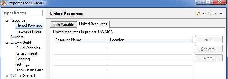

I searched on line and noticed someone mentioned the "Linked Resources" option. But in my project, this option is empty and can't be edited. It's the same in CodeWarrior IDE. It seems this option doesn't make sense.
