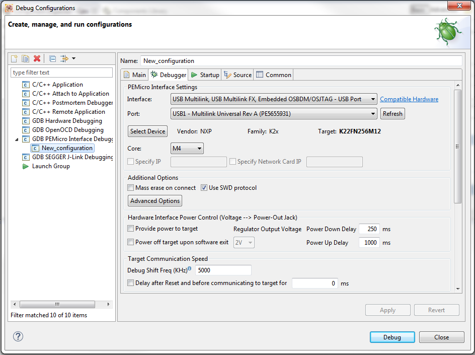

Hi, this message never comes up when I'm at my office, only when I'm at home.
Known:
KDS Version 3.2.0
PE Micro Multilink Universal
MK22FN256VLH12
What I notice is at work when I choose 'Build Project', a file called 'EyeRelief.elf' is created.
I navigate to Debug Configurations and see 'EyeRelief.elf' at the location "C/C++ Application:"
Before I leave work I copy the entire project file to my thumb drive.
When I get on my home computer:
I drop the project on my desktop and I can still see EyeRelief.elf in the debug folder.
I then try to compile and I get the message below:
I then look in my debug folder and the EyeRelief.elf file is no longer there.
One attempt I tried to use to try and resolve this issue is:
Right-Click on Project Name, followed by 'Clean Project'.  I try and compile again with the same results.
Below are a couple of screen captures that I hope will provide some insight:
The capture above is what I see when I select "New_configuration" >> Main Tab
The capture above is what I see when I select "New_configuration" >> Debugger Tab
Can someone give me some guidance on how to correct this?
Brian

Hello Brian,
From your description, there is problem when you build ,
I think maybe after you copy the project, the path has some error , please check it .
Or you can also share it , I help you check it on my side .
If the project is private , you can also submit a service request on NXP to send it :
How to submit a new question for NXP Support
Hope it helps
