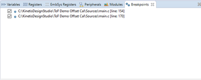

I'm currently working on a project with the MK10DX and an LPC-Link2 for debugging. Recently, I've realized that none of my breakpoints seem to be recognize when debugging.
I tried a few things already like double checking the debug configuration, or that I did not disable every breakpoint, only having a single breakpoint, or running other projects and nothing seems to work.
Has this been an issue for anyone before, or can anyone suggest what else to look into?

can you possibly share more what you see? For example the console log what the debug connection does, what the breakpoints view show, etc?

There is no checkmark, just the blue button. These screens would hopefully help:
Console view does not give me anything explicit regarding these besides a few warnings linked to syntax.
Thank you.

And the code has not been removed (dead-stripped) by the linker?
Can you check the linker map file if the functions where you set the breakpoints really exist.

The functions seem to all run as intended. I can step through each of them while running as well, but the breakpoint issue still persists.

Does the breakpoint have the blue 'checkmark' set when you set the breakpoint?
What does the breakpoint view say/show?
And: any useful information in the console view, maybe showing the reason why it failed to set the breakpoint?
