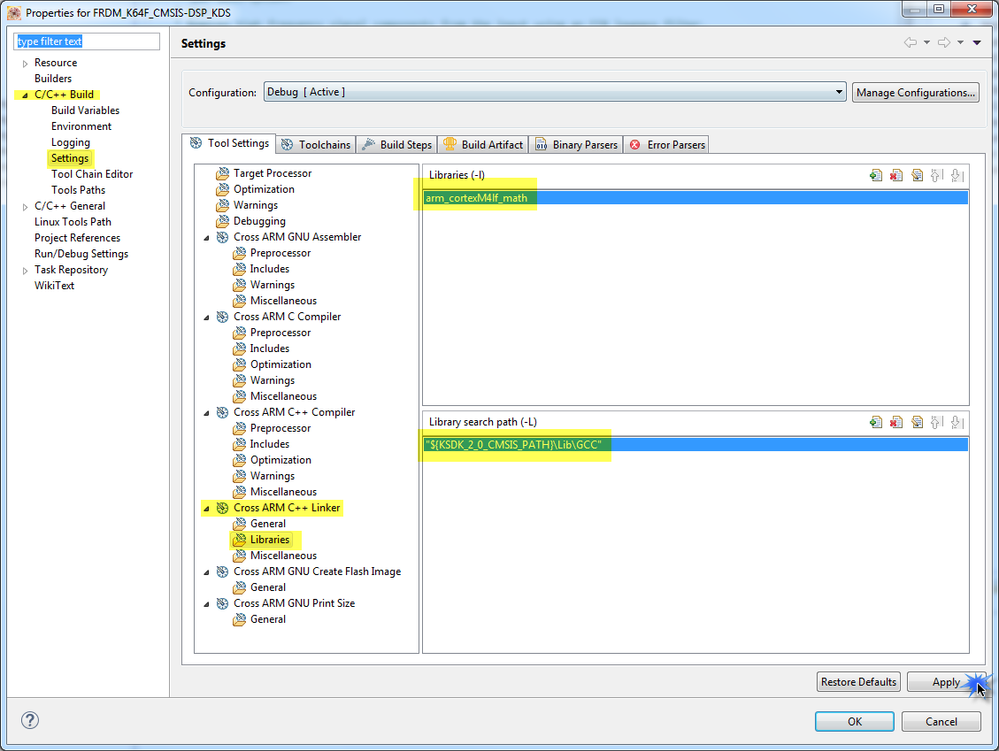

to link a library to a project, go to C/C++ Build > Settings > Cross ARM C++ Linker > Libraries and specify the precompiled library to be used and its path.
for example
the library .a or .lib file doesn't include address information, after linking it to project, the linker will allocate range of memory address to library code.
if you still have overlap error with above setting, So I wonder your library defines some constant variable in the exact address?
