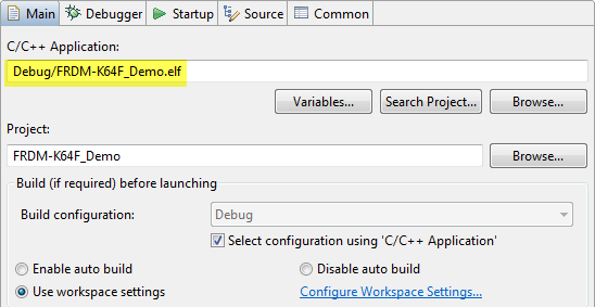

I work on a project which using MK10DX128VLF5, and using KDS+JLink for debug. I just new a bare project and config debug configuration, then start debug,  but KDS reported "Program file does not exist".
I can make sure that my board can work normally, because i use codewarrior instead of KDS, then debug work normally.
"Program file does not exist" seems related to the consistently of the chip type and Device name in debug configureation and also devices info when new the project, is it? but I'm sure they are consistent in my application.
Does anyone have similar problem as me and give me some suggestion? Thanks in advance!

If it says "Program file does not exists", it probably means exactly this.
Can you check your debug configuration?
Check that you have a .elf file specified, and that it actually exists in that folder?
If there is the correct .elf file specified, but it does not exist, then probably you have not build your application, or it failed?

Hi Erich,
You are so smart! There really no .elf file specified in debug configuration.
I new the new debug configuration first, but build the project after that, then .elf will not specified in the debug configuration.
Debugging can work when .elf specified, thanks very much Erich!
