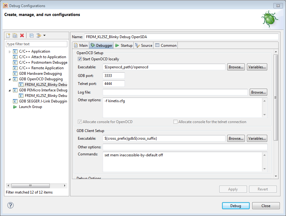

For the Windows version of SDK, I was not able to use the OpenSDA with CMSIS-DAP running on the FRDM-KL25Z..
The Quick Start guide Figure 12 shows the a blank field for "Other options".
You must enter "-f kinetis.cfg" here or you will not be able to debug.
See below.
