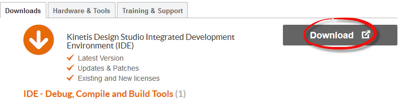

Download the Installer
  1. Go to Kinetis Design Studio Integrated Development |NXP
  2. Under the Downloads tab, click the button to Download the software

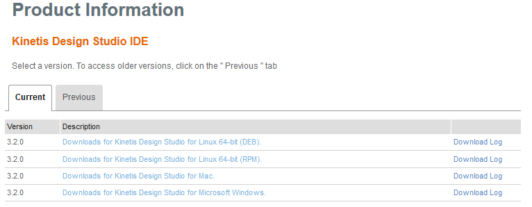

  3. Select the host operating system for which you want to download the installer:
  4. You need to agree on the license agreement

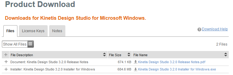

  5. Download the Installer and release notes which contain additional installation instructions:
  6. Install the software and consult the release notes for additional installation instructions. Release notes are attached to this document too.
