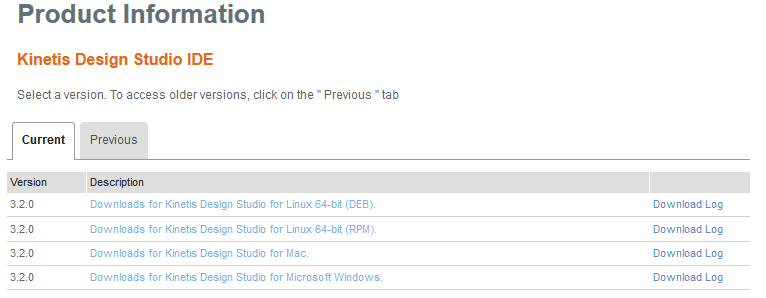

Download the Installer
  1. Go to Kinetis Design Studio Integrated Development |NXP
  2. Under the Downloads tab, click the button to Download the software
  3. Select the host operating system for which you want to download the installer:
  4. You need to agree on the license agreement
  5. Download the Installer and release notes which contain additional installation instructions:
  6. Install the software and consult the release notes for additional installation instructions. Release notes are attached to this document too.

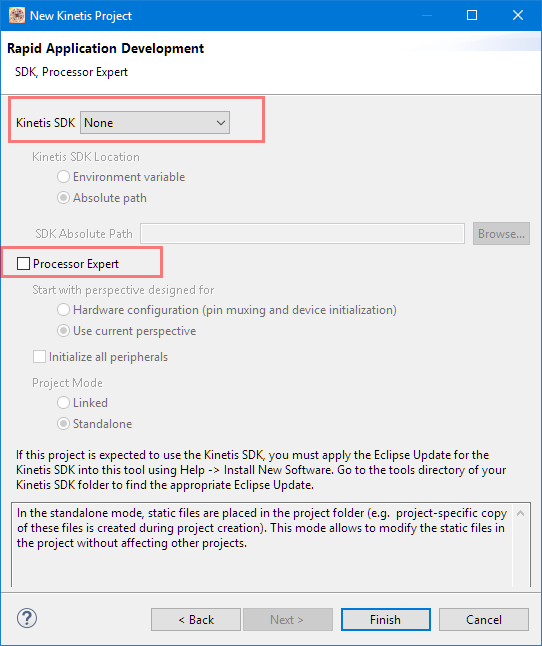

There are options for KSDK 2.0, KSDK 1.3 and PE projects, but the simpler "Kinetis Project" disappeared. Any option to create one without KSDK or PE?
Iñigo.
Hi Inigo,
simply create a Processor Expert and disable it in the settings:
Erich
Thank you Erich.
That menu has changed from version 3.0 and I thought, erroneously, that the other options were not "tuneable".
I could just tried... Sorry.
Iñigo.

I click on the link to download KDS 3.2.0 for Windows, but nothing happens?  Can anyone help here?
