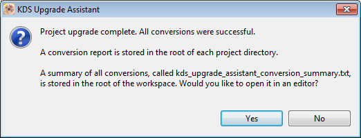

KDS Upgrade Assistant

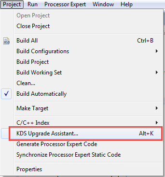

Kinetis Design Studio V3.0.0 comes with a migration assistant to migrate projects to the GCC ARM Embedded (launchpad) tools. The migration assistant is accessible from the menu Project > KDS Upgrade Assistant:
This opens a dialog with the currently open projects in the workspace:
NOTE: if the Upgrade Assistant does not list your project, then you still can do the manual steps as listed below (changing the linker flags).
Select the project(s) you want to migrate and press Next.

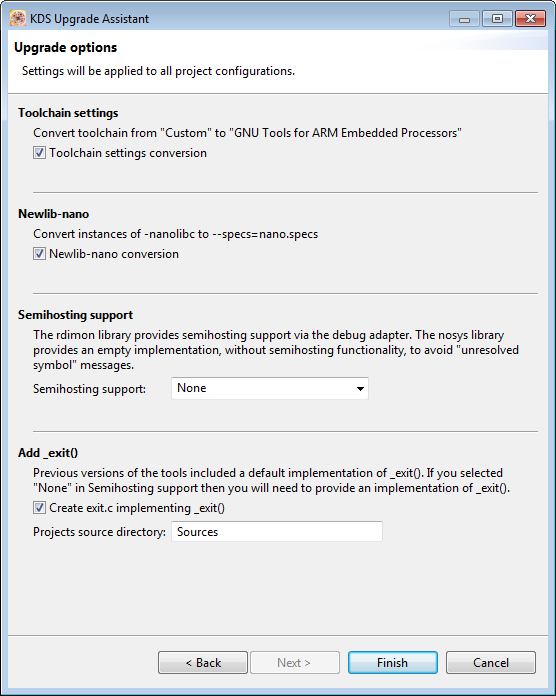

In the next dialog you can configure the details of the conversion, then press Finish:
A report will be generated in each project directory:

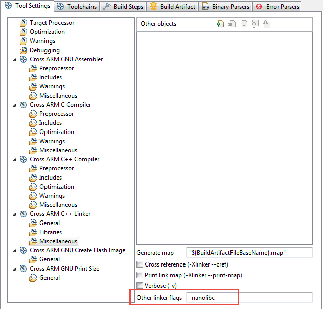

To migrate an existing 'legacy' project to a 'launchpad' project, usually only the linker settings need to be changed. For this go into the project properties, and check the 'Other linker flags' settings of the Linker. The table below shows the difference between the two:
Legacy 'Other linker flags'Launchpad 'Other linker flags'
<none>-specs=nosys.specs
-nanolibc-specs=nano.specs -specs=nosys.specs

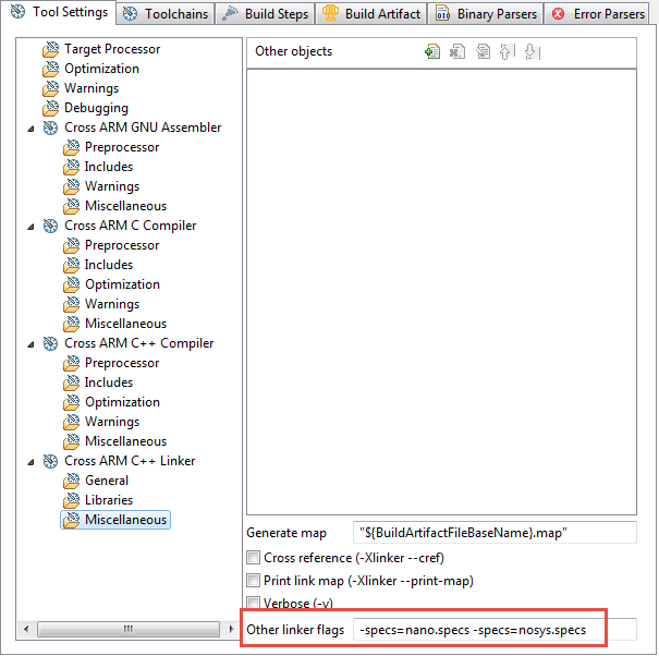

For example this project is a legacy project using the newlib-nano library:
To use it with the 'launchpad' toolchain, use
as shown below:
With this, normally projects are converted from the 'legacy' to the 'launchpad' toolchain.

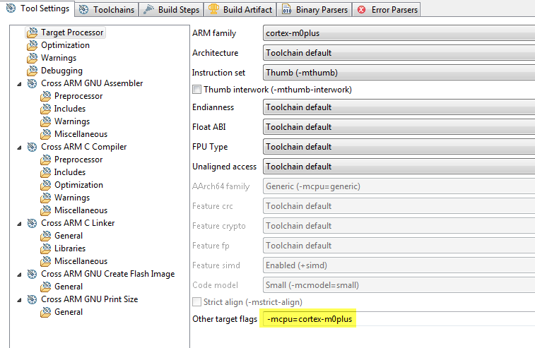

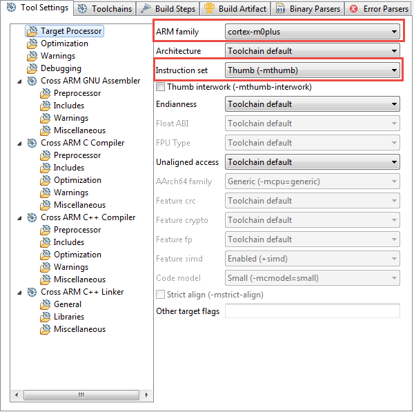

Wrong or missing Thumb mode

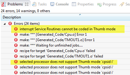

If getting errors like
     Error: selected processor does not support Thumb mode
     error: interrupt Service Routines cannot be coded in Thumb mode
This means that the project settings do not properly pass the processor to the compiler. That problem mainly occurs with Kinetis SDK projects, and with Cortex-M0+ (Kinetis-L) projects.
As explained in the next section, the launchpad tools by default use the ARM, not the thumb mode.
The solution is to add
     -mcpu=cortex-m0plus
for these Kinetis-L projects to the compiler 'Other target flags'.

The default options for the 'legacy' toolchain produce code for the ARM Cortex-M0+ (Thumb mode), while the 'launchpad' tools default to the 'ARM' mode (non-Thumb). Therefore it is important that the command line options -mthumb with the appropriate -mcpu= or -march= options are used if using the tools in command line only mode. If using the GNU ARM Eclipse plugins, then no changes are needed as these options are set in the project already:

A typical legacy Kinetis Design Studio (KDS) V2.0.0 project can be easily migrated to the launchpad toolchain with adding -specs=nosys.specs linker option and replacing the -nanolibc legacy option with -specs=nano.specs linker option.

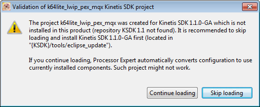

Hi BlackNight​, thanks for sharing this document.  I have a question regarding the project conversion process.  For those project previously written using KSDK 1.1, KDS 3.0 is going to ask us to install the KSDK 1.1.0-GA update:
When I first loaded the project, I clicked "Skip loading", and then proceeded with the project conversion.  It completed successfully.  My thought was that after closing and re-opening the upgraded project, I would no longer get this message.  However, that's not the case.
At this point, I'm not sure what to do because I don't know how the 1.1.0-GA update will interact in KDS 3 when the 1.2.0-GA update is already installed.  I do know that clicking Continue loading results in a project that doesn't work.

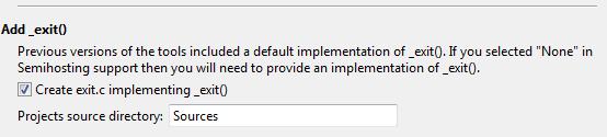

I have tried to use the "KDS upgrade assistant" tool to migrate KDS2.0 projects with KSDK1.1 to KDS3.0 version. I am trying to convert the KSDK libs, MQX libs, USBH libs and usb host demo projects. All succeeded except the usb host demo.
I got a failure message as follows.
  Project name: host_msd_fatfs_frdmk64f_mqx_frdmk64f
  Project location: C:/Freescale/KSDK_1.1.0/usb/example/host/msd/msd_fatfs/sdk/kds/host_msd_fatfs_frdmk64f_mqx
  Conversion status: failure.
  Add exit() file failure: A resource exists with a different case: '/host_msd_fatfs_frdmk64f_mqx_frdmk64f/sources'.
So do I need to apply the last step in upgrade option?
Hao
It seems that your project already has a file exit.c with _exit() in it, so you do not need to do this last step.
Erich
