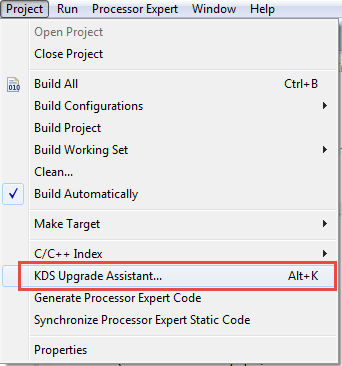

KDS Upgrade Assistant
Kinetis Design Studio V3.0.0 comes with a migration assistant to migrate projects to the GCC ARM Embedded (launchpad) tools. The migration assistant is accessible from the menu Project > KDS Upgrade Assistant:

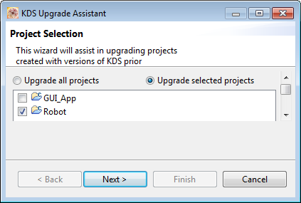

This opens a dialog with the currently open projects in the workspace:
NOTE: if the Upgrade Assistant does not list your project, then you still can do the manual steps as listed below (changing the linker flags).
Select the project(s) you want to migrate and press Next.

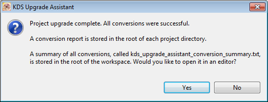

In the next dialog you can configure the details of the conversion, then press Finish:
A report will be generated in each project directory:

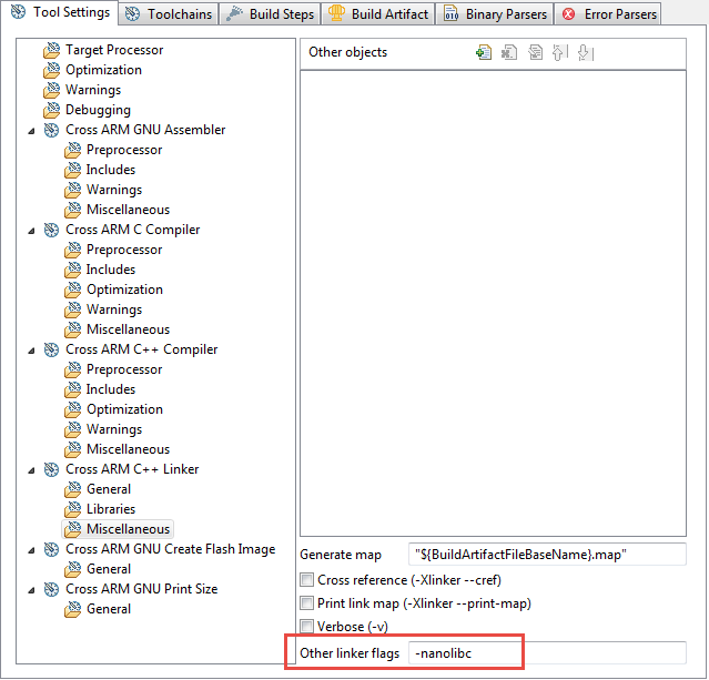

To migrate an existing 'legacy' project to a 'launchpad' project, usually only the linker settings need to be changed. For this go into the project properties, and check the 'Other linker flags' settings of the Linker. The table below shows the difference between the two:
Legacy 'Other linker flags'Launchpad 'Other linker flags'
<none>-specs=nosys.specs
-nanolibc-specs=nano.specs -specs=nosys.specs
For example this project is a legacy project using the newlib-nano library:
To use it with the 'launchpad' toolchain, use
as shown below:
With this, normally projects are converted from the 'legacy' to the 'launchpad' toolchain.
NOTE: after switching toolchains, delete all intermediate or object files (e.g. delete the Debug/Output folder inside the project. Mixing object files or libraries from different toolchains and compilers will likely cause problems.

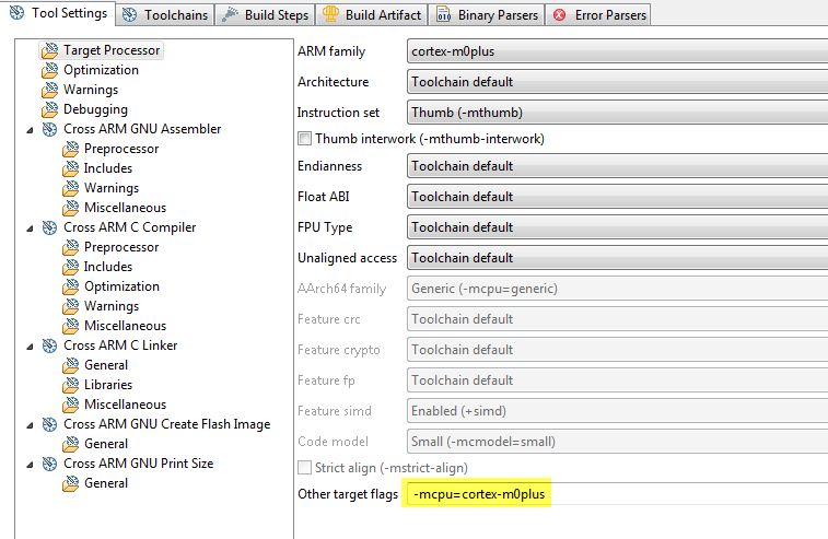

Wrong or missing Thumb mode
If getting errors like
     Error: selected processor does not support Thumb mode
     error: interrupt Service Routines cannot be coded in Thumb mode
This means that the project settings do not properly pass the processor to the compiler. That problem mainly occurs with Kinetis SDK projects, and with Cortex-M0+ (Kinetis-L) projects.
As explained in the next section, the launchpad tools by default use the ARM, not the thumb mode.
The solution is to add
     -mcpu=cortex-m0plus
for these Kinetis-L projects to the compiler 'Other target flags'.

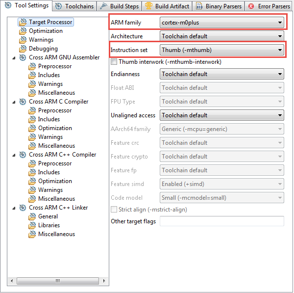

ARM Default Mode
The default options for the 'legacy' toolchain produce code for the ARM Cortex-M0+ (Thumb mode), while the 'launchpad' tools default to the 'ARM' mode (non-Thumb). Therefore it is important that the command line options -mthumb with the appropriate -mcpu= or -march= options are used if using the tools in command line only mode. If using the GNU ARM Eclipse plugins, then no changes are needed as these options are set in the project already:
