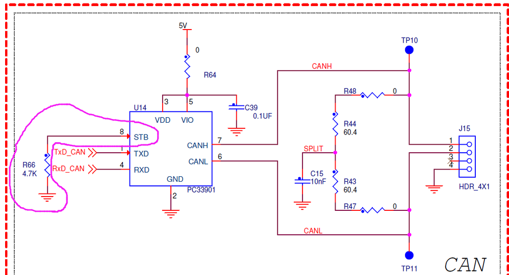

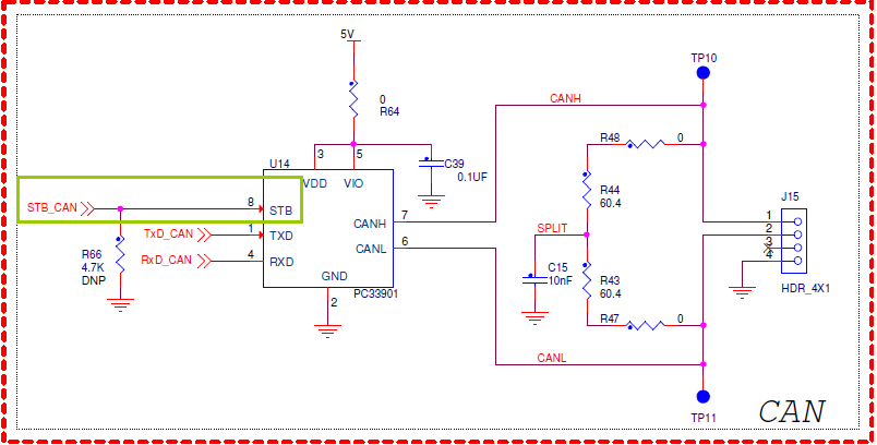

Pay attention to that, if your board is TRK-KEA128 Rev D, you need give a low signal to STB of PC33901 chip to set it in Normal mode:
    GPIOB_PDDR |= (1<<16);
    GPIOB_PCOR = (1<<16);
In other old version boards , for example Rev C, the STB have been connected to ground , so we needn't configure it .
