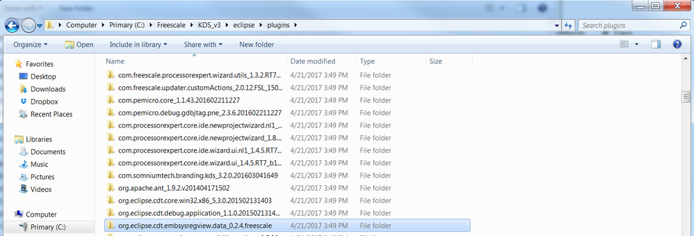

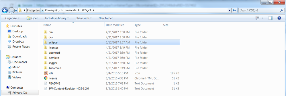

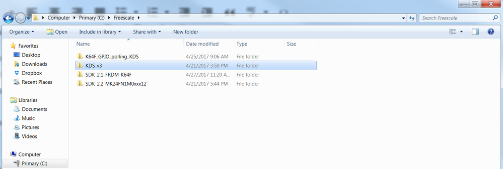

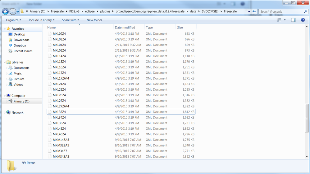

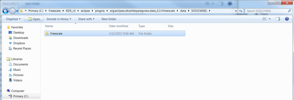

1. First of all it is needed to know where the Embsys Registers' Folder is located. Go to the folder where KDS is installed.
2. Go to eclipse folder.
3. \org.eclipse.cdt.embsysregview.data_0.2.4.freescale
4. \data
5. \SVD(CMSIS)
6. \Freescale
8. Finally this folder contains XML files, these files can be processed purely as data by the program.

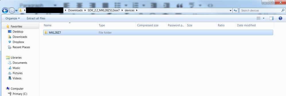

1. go to your chip's package (In my case \SDK_2.2_MKL28Z512xxx7.zip).
Note: If you don't know where to build a package, please go to the following post: https://community.nxp.com/docs/DOC-333304
2. \SDK_2.2_MKL28Z512xxx7.zip\devices
3. \SDK_2.2_MKL28Z512xxx7.zip\devices\MKL28Z7

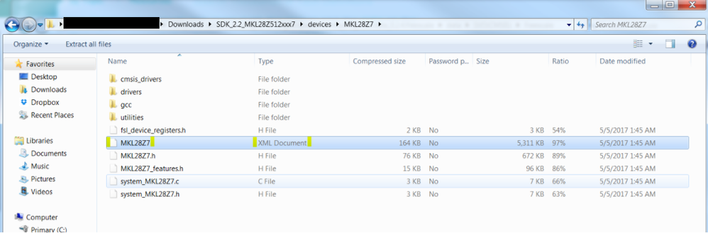

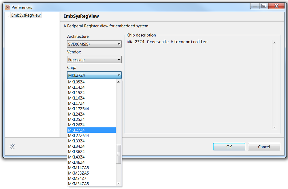

As you can see, the MKL28Z7 is not available in EmbsysRegView.
Locate the XML and copy it to the route:
C:\Freescale\KDS_v3\eclipse\plugins\org.eclipse.cdt.embsysregview.data_0.2.4.freescale\data\SVD(CMSIS)\Freescale
Paste it in Freescale's folder:

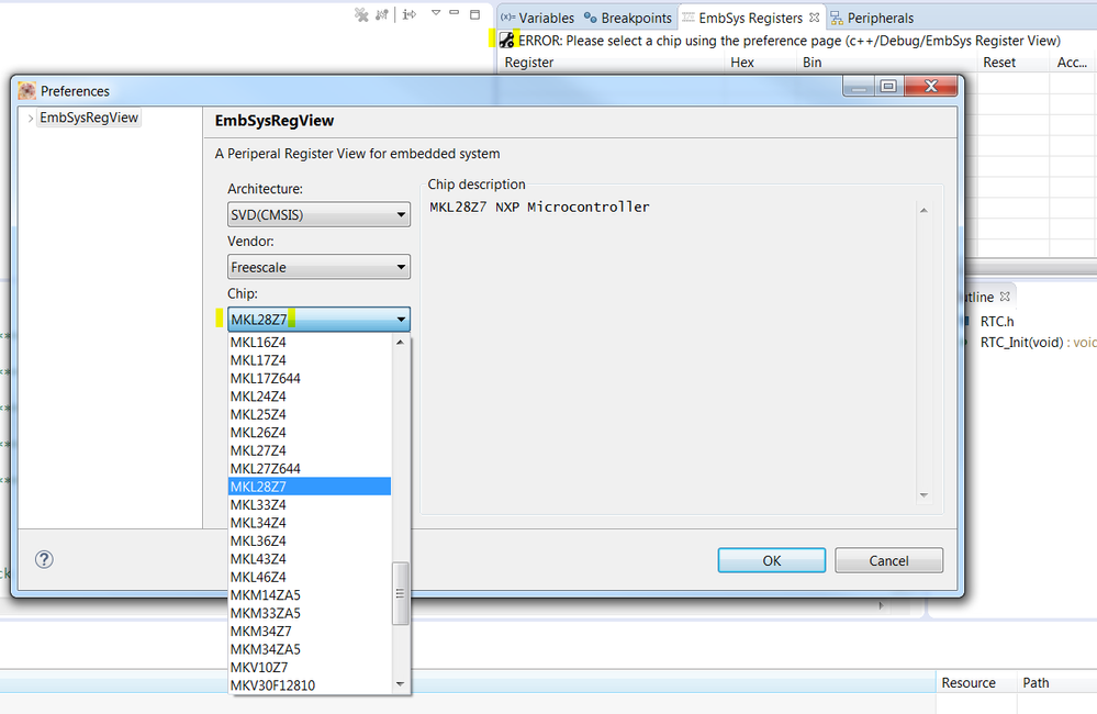

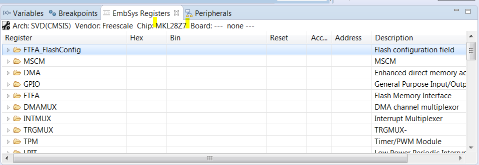

Go to EmbSysRegView again and now it will be available
Restart Kinetis Design Studio and you'll be able to see your chip's registers:
