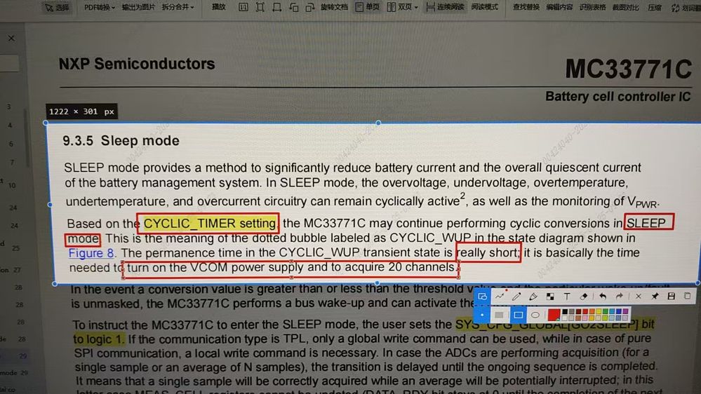

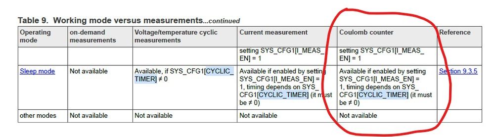

But I see here that sleep mode is possible, could you please help me confirm again?
Another question, does SC33771C need to be reinitialized after entering sleep and then being awakened by CSB?
We want to be able to continuously obtain sleep time and Coulomb count values while SC33771 is asleep, but will the Coulomb count related registers clear 0 after initialization?

will the Coulomb count related registers clear to 0 after initialization?
Yes, they can be cleared during initialization or reset, but they do not automatically reset to zero unless explicitly commanded:
The COULOMB_CNT1/2 and CC_NB_SAMPLES registers retain their values unless:
A reset command is issued via ADC_CFG [CC_RST] = 1.
A power-on reset (POR) or software reset is triggered.
During sleep, coulomb counting continues, and CC_NB_SAMPLES can saturate to 0xFFFF if not read/reset periodically. [mc33771 sl...Community]
Overflow is indicated by the CC_OVR_FLT flag, and if unmasked, it will activate the FAULT pin.
So, if your goal is to track Coulomb count continuously during sleep, make sure store the values before reset or reinitialization.
