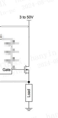

GPIO 1 need to be configured as “high side
Currently configured as push-pull. Can you provide a rough drawing of the circuit use case? Change to review
For battery heating function in the Pack application concerns ,Cosmx need a high side driver output for the circuit. Otherwise we need to add other circuits and diagnostic strategy can not be integrated. See the circuit below for reference figure1.
There is no 9V output voltage for FS2633 on VBST.
Datasheet only provides some estimates of the output current for some voltages, however 9V is possible, we can do the needed calculations, based on your output current, if we decide to do a new OTP, we can select 8V instead. Change to review
For VBST circuit in the low voltage input range like 4V ~6V ,the boost need to be activated and the current need to be monitored for Safety. 8V is ok.
