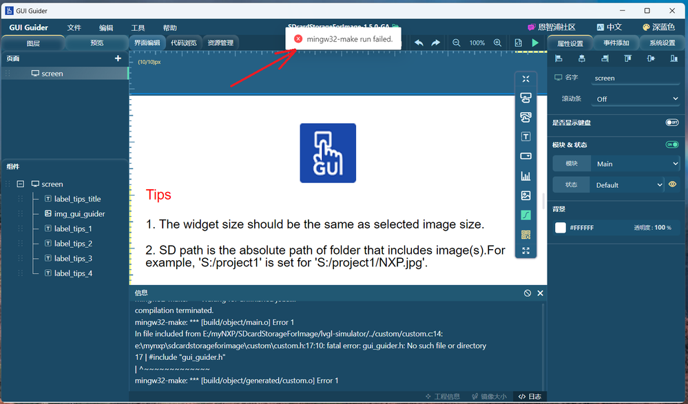

请教:
Gui_Guider 1.5.0 , 模拟器,选择C语音,然后出现提示: mingw32-make run failed ,应当如何解决?

LiubinGong
Hi bigheadJano
    Can you check the java version on your host? if it is lower than 1.8.
please upgrade the Java version to 1.8.0 or higher, Reopen the GUIGuider and rebuild this project. if it still doesn't work, Please share the test project for debugging. Thank you very much for your support. BR Liubin

LiubinGong
In order to better reproduce the problem, please provide the following information:
  1. host OS
  2. project created version(1.5.0 or other version)
  3. Is there a 'make' in the system environment variable?
  4. would you share the error log info?
  5. v7 work fine, but v8 failed, all right?
Best Regards
Liubin

LiubinGong
Can you build this project by command line mode?  Please follow blew steps:
  1. cd {project path}/lvgl-simulator
  2. make -r -j4;
And would you please share the full build log? Thanks
Best Regards

LiubinGong
Can you check the java version on your host? if it is lower than 1.8,
  1. please upgrade the Java version to 1.8.0 or higher,
  2. Reopen the GUIGuider and rebuild this project.

LiubinGong
According to checking your test project, I found that the code of GUI GUIder is not generated, it should be the problem with the version of JAVA,  Would you check your java version?
Best Regards
Liubin

LiubinGong
是java 版本不能低于1.8, 不是python 版本。请您检查一下您系统中安装的java 版本
